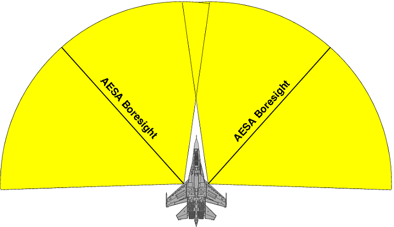

2) عندك رادارات جانبية وخلفية ومنها ما هو عامل على النطاق L-band لكشف الاهداف المعادية الشبحية والعادية في حالة التشويش (تشويش على الاواكسات والاقمار الصناعية والصواريخ) وكانذار مبكر ... ناخد الرادارات الجانبية كمثال وهي من النوع ايسا:
Tikhomirov NIIP L-band AESA
- Search, track and missile midcourse guidance against low signature aircraft.
- Identification Friend Foe / Secondary Surveillance Radar.
- Passive angle tracking and geolocation of JTIDS/MIDS/Link-16 emitters at long ranges.
- Passive angle tracking and geolocation of L-band AEW&C/AWACS and surface based search radars at long ranges.
- Passive angle tracking and geolocation of hostile (i.e. Western) IFF and SSR transponders at long ranges.
- High power active jamming of JTIDS/MIDS/Link-16 emitters.
- High power active jamming of satellite navigation receivers over large areas.
- High power active jamming of L-band AEW&C/AWACS and surface based search radars at long ranges.
- High power active jamming of guided munition command datalinks over large areas.

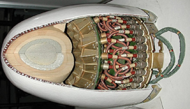

3) البودات الجانبية على الاجنحة ... ناخد مثال
KNIRTI SPS-171 / L005S Sorbtsiya-S H/I band ECM pods
شغال انذار وتحذير وفي نفس الوقت تشويش زي السبكترا ولكن متعدد الاطوار الموجية (لا اجد مصادر تتكلم عن الطوار الموجي الذي تعمل عليه السبيكترا وهل هو متعدد الاطوار ايضا ام لا)
Defensive systems include a Radar Warning Receiver, most likely the current variant of the SPO-32 / L150 Pastel digital receiver carried by the Su-27/30. The podded wingtip mounted KNIRTI SPS-171 / L005S Sorbtsiya-S H/I band defensive jammer has been reported, this system being an evolution of a jammer developed for the Backfire C. The Sorbtsiya-S, unlike most Western jamming pods, is designed to operate in pairs and uses forward and aft looking steerable wideband phased arrays to maximise jamming effect. It is worth observing that the Sorbtsiya is clearly built to provide cross-eye jamming modes against monopulse threats, and the wideband mainlobe steering capability provided by the phased array permits best possible utilisation of available jamming power. A graded dielectric lens is employed (refer image below).
بص كده شغال على كام باند (نطاق موجي) L005S Sorbtsiya-S H/I band كتحذير وتشويش ده غير الرادار الرئيسي الي شغال x-band والرادارات الجانبية الي شغالة L-band ... هذا ليس كل شيئ ... لسة في بلاوي تانية ما تكلمناش عليها على سبيل المثال لا الحصر: IRST - HDTV - OLS
