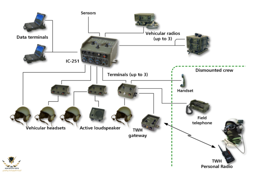

ICC-251 COMPACT DIGITAL INTERCOM SYSTEM
http://www.eid.pt/prod/18/icc-251_compact_digital_intercom_system/52/Overview
The ICC-251 is a Compact Digital Intercom System that provides voice and data communications among crew members of armoured vehicles, as well as their access to the radio communication channels made available through the equipment installed on-board. The system is also suitable for fast patrol boats, small vessels and shelters.
The system is composed of the IC-251 Central Unit and a variety of user terminals and accessories which are common to the ICC-201 IP Intercom system. The IC-251 design provides on the same unit both Central Unit and Commander Terminal functionalities.
Furthermore, it allows connection to up to 3 crew terminals, 3 radios (voice, data and remote control), alarms and serial connections (RS232) to a laptop. When using double crew terminals, up to 7 crew members can be connected to IC-251.
The connection between the IC-251 and Crew Terminals is fully digital, requiring only two-wire cables, which also feed the power to the terminals. This small number of conductors increases system reliability and reduces the space needed for cable routing inside the vehicle. Wireless terminals are available avoiding cabling between them and IC-251.
The system is compatible with radio equipment from all major suppliers, supporting radio features such as voice and data services as well as remote control (whenever available). The operational scenario of the ICC-251 can be customized according to the user needs by a software configuration tool running on a laptop.
As mentioned above, several types of user terminals are available, namely double user and wireless ones. Headsets with active noise reduction as well as wireless headsets are provided to deal with the most demanding applications. An active and efficient 15W loudspeaker is also available for communications monitoring without the need to wear headsets.
مشاهدة المرفق 327028
Typical vehicle communications system based on ICC-251

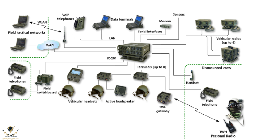

ICC-201 IP INTERCOM SYSTEM
The ICC-201 IP Intercom System is an hardware infrastructure and software applications suite that allows local communications among crew members of armoured vehicles, small vessels or shelters and their access to radio equipment. Voice and data communications are supported, either over the air, standard copper and optical fibre cables.
For vehicles where space is at a premium and IP technology is not a requisite, but advanced features such as noise cancelation, voice priority over data and radio remote control still to be required, EID designed an alternative solution, the ICC-251 Compact Digital Intercom System.
The ICC-201 supports voice, data, radio remote control and features active noise cancellation for high quality voice intercom in very noisy environments, being compatible with several existing combat net radios.
The ICC-201 also features Ethernet switching and, as an option, embedded IP routing capability. System configuration and upgrade is easily carried out through a flexible, user-friendly software management tool.
A grahical user console is also available, featuring user interface with system status report, online features activation and VOIP operation. The application runs on the optional embedded computer of the ICC-201 or any external rugged data platform.
A variety of user terminals is available, ranging from commander and crew terminals to dual-user and wireless ones. Headsets with active noise reduction and wireless headsets are provided for the most demanding applications. An active and efficient 15W loudspeaker for communications monitoring without the need to wear headsets completes the ICC-201 range of accessories.
مشاهدة المرفق 327029
Typical vehicle communications system based on ICC-201
