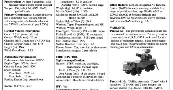

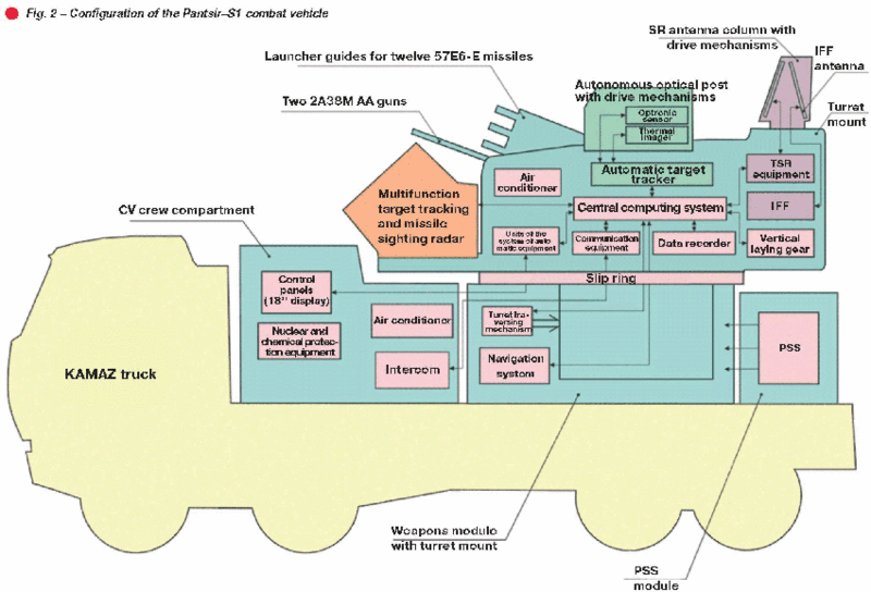

وهنا اشارة لوجود الـ IFF
وجزئية اخرى تحدثت عن تطويره ,, ورد ذكر دمج الـ IFF فيه
Development
Development as Pantsir-S started in 1990 planned to be successor of Tunguska M1.Prototype completed in 1994 and on display on MAKS-1995. Further development stopped due to economic situation in Russia.Final development to Pantsir-S1 funded by launch customer UAE in 2000.Delivery postponed after United Arab Emirates and KBP Instrument Design Bureau agreed to redesign the system.
Some sources refers this redesign as Pantsir-S1-O or Pantsir-S1E but it is as of August 2007 not offered by KBP as a separate variant. The system has two new radars with increased range, capable of tracking more air targets but also land targets and have integrated IFF.Within the cabin two new LCD multi-function displays have replaced the multiple CRT display and a new central computer system greatly decreased the reaction time, single operator operation can be achieved when needed. Due to the new technologies adopted, the overall volume of the weapon station is reduced by a third while the overall weight is reduced by a half. System has also enhanced missiles (from type 57E6 to type 57E6-E probably interchangeable) and guns (from type 2A72 to type 2A38M).
Live firing tests undertaken in June 2006 at the Kapustin Yar firing range, Astrakhan Region, Russia.Final test series in front of delivery in May 2007 at Kapustin Yar included a forced march of 250 km to an unprepared launch position simulating the accomplishing of a typical air-defence mission. Further tests will be taken place in the UAE.

وهنا حديث عن حل معضلة دمج IFF البانتسير ضمن نظام IFF المستخدم والتي تم حلّها بحسب المصدر
Adherence to modular concept was applied not only to design of the system but to its software as well. That was the way to solve the issues of integration into IFF system existing with each of the Customers. The issue of upgrading the IFF system in case the Customer’s decision to change it was also worked out.
http://www.spslandforces.com/story.asp?id=404
سبب الاعتقاد ايضا ان سابقه التانجوسكا مدمج فيه نظام IFF من نوع 1RL138
The missile requirement led to the unusual two stage 9M311 design, in which the first stage boosted the round to 900 m/s at burnout, the sustainer in the terminal stage burning to impact and maintaining a 600 m/s velocity. The missile employs command link guidance, with an automatic Command to Line Of Sight (CLOS) control loop for the terminal phase to impact, with an 18G capability. The engagement radar component of the 1RL144M Hot Shot system is claimed to operate in the millimetric band, using jam resistant monopulse angle tracking; a 1A29M optical sight is boresighted with the radar. A 1RL138 IFF system is included. Conceptually the 2S6 missile package has its closest Western equivalents in the Franco-German Roland system, and the UK Rapier Blindfire and Seawold systems.
http://www.ausairpower.net/APA-96K6-Pantsir-2K22-Tunguska.html

البانسيتر اس 1 لا يعمل بمنظومات التعريف IFF ولا أي منظومة شرقية تعمل كذلك ولا ادري لماذا كلاب سبوتنيك الناطقين بالعربية فريحين في مقالهم بالحادثة .. وقالوا اصطاد البانستير البلاك هوك !! ..
لقد خدعوا العرب الذين اشتروا منهم سلاح ... فالمصير سيتكرر كل مرة وبشكل اسوء
التعريف هنا يجري باللاسلكي .. واشارة اللاسلكي معرضة للخلل المتوقع في بيئة تضاريس مثل اليمن .. فقدان الاتصال .. مع زخم عملياتي النتيجة الطبيعية هي وقوع خطاء كهذا ...
يابو هزاع مو فكرة الIFF انه الرادار يرسل على تردد في موجة محددة للهدف ثم الهدف يرد برضه بتردد وموجة متفق عليها ؟!
وليه لازم في اجهزة خاصة للIFF في منظومات الاسلحة المختلفة ؟! ولا هذا بس عند الناتو ؟!
بخصوص فقدان الاتصال هذا اقرب تفسير
الحديث كان عن وجود منطقه محظور الطيران فيها وسوء او فقدان الاتصال بين المروحيه و مسؤل الدفاع الجوي على الارض تسبب باطلاق الصاروخ بشكل الي
هذا التفسير يوضح لما لم يكن هناك اخطاء او حوادث مشابهه مع ان البانسيتر و البلاك هوك موجودين من بدايه الحرب
