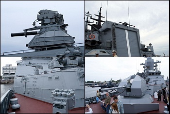

3x4 launchers SAM system «Redut» (32 missiles 9M96 or 9M96D or 48 missiles 9M100) (№1001 – 1 module CIWS 3M87-1 «Kortik-M» – 8 launchers SAM, 2x6 30 mm (64 missiles 9M311, 12000 rounds)), Project 20385 – 4x4 vertical launchers 3S97 SAM system 3K96 «Redut» (16 missiles 9M96 or 9M96D or 64 missiles 9M100))
SAM system 9K38 «Igla» » (8 missiles 9M39)
1x1 100 mm A-190-01 – Fire control system 5P-10-02 «Puma-02» (Project 20385 - without fire control system)
2x6 30 mm AK-630M – Fire control system SP-521 «Rakurs»
1x1 45 mm 21KM – on Boikiy
