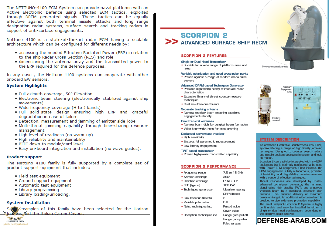

هناك منظومة Scorpion 2 من طاليس :
ADVANCED RADAR ELECTRONIC COUNTERMEASURES FOR ALL NAVAL PLATFORMS
An advanced Electronic Countermeasures (ECM) system offering a range of high fidelity jamming techniques. Designed to counter search radars and missile seekers operating in search and lock on
modes
. Scorpion 2 can easily be integrated with any ESM equipment but is optimally configured to be used with Thales' ESM equipment. Once initiated, the ECM engagement is fully autonomous, providing high-stability and high-fidelity countermeasures with a range of effective techniques. Threat responses are developed by Thales’ advanced techniques generator, the jamming signal using high stability TWTs and a narrow transmit beam by a stabilised, steerable dish antenna. This ensures delivery of maximum power on target. An additional wide beam horn is provided to give wide area protection capability. The small footprint Scorpion 2 System is highly configurable and may be installed in either a single or dual head configuration, dependent on the platform scale and role.
Scorpion 2 employs modern
technology :
• Advanced DRFM-based Techniques
Generator
• Wide range of noise and deception
jamming techniques to counter modern
threats
• Steerable antenna unit with polarisation
control
• Flexible installation options to optimize
performance on the platform
https://www.thalesgroup.com/sites/default/files/asset/document/Scorpion2.pdf

رائع اشكرك النظامين متقاربان نوعا ما
ال elevation اكبر في الايطالية
منظومات ال ELT/888 و ال seal ايضا اضافة قوية
لكن الاولي تحتاج لاعادة تجهيز الفريم بشكل اكبر فهي كبيرة الحجم
http://www.elettronica-elt-roma.com/index.php/en/naval-eng/nettuno-4100

جبتهالك و عندك حق فعلا الموضوع سيكون بامتلاك السكوربين 2 عوضا عن ال NETTUNO - 4100 و بامكان
المنظومة ال esm العمل لوحدها مستقلة

منظومه scorpion 2 لأجراءات الاعاقه الالكترونيه والتشويش ضد العدو ECM موجوده علي الكورفيت الفرنسي GOWIND القادم الي البحريه المصريه
عندك مصدر عشان بنسبة 70% ستكون هي البديل على الفريم ايضا
