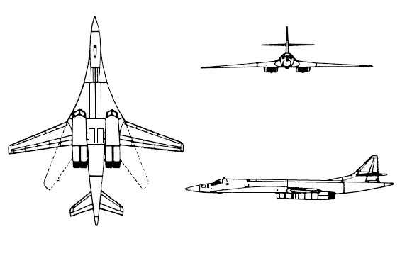

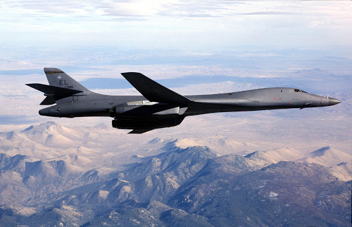

b1 lancer
General characteristics
Crew: 4 (aircraft commander, copilot, offensive systems officer and defensive systems officer)
Length: 146 ft (44.5 m)
Wingspan:
Extended: 137 ft (41.8 m)
Swept: 79 ft (24.1 m)
Height: 34 ft (10.4 m)
Wing area: 1,950 ft² (181.2 m²)
Airfoil: NA69-190-2
Empty weight: 192,000 lb (87,100 kg)
Loaded weight: 326,000 lb (148,000 kg)
Max takeoff weight: 477,000 lb (216,400 kg)
Powerplant: 4× General Electric F101-GE-102 augmented turbofans
Dry thrust: 14,600 lbf (64.9 kN) each
Thrust with afterburner: 30,780 lbf (136.92 kN) each
Fuel capacity, optional: 10,000 U.S. gal (38,000 L) fuel tank for 1-3 internal weapons bays each
Performance
Maximum speed: Mach 1.25 (950 mph, 1,529 km/h) at altitude (Mach 0.92, 700 mph, 1,130 km/h at low level)
Range: 6,478 nmi (7,456 mi, 11,998 km)
Combat radius: 2,993 nmi (3,445 mi, 5,543 km)
Service ceiling 60,000 ft (18,000 m)
Wing loading: 167 lb/ft² (816 kg/m²)
Thrust/weight: 0.37
Armament
Hardpoints: six external hardpoints for 59,000 lb (27,000 kg) of ordnance (use for weapons currently restricted by START I treaty[67]) and 3 internal bomb bays for 75,000 lb (34,000 kg) of ordnance to carry from:
Missiles:
24× AGM-158 JASSM
Bombs:
84× Mk-82 AIR inflatable retarder general purpose bombs[59]
81× Mk-82 low drag general purpose bombs[60]
84× Mk-62 Quickstrike sea mines[61]
8× Mk-65 naval mines
30× CBU-87/89/CBU-97 Cluster Bomb Units (CBU)[62]
30× CBU-103/104/105 WCMD
24× GBU-31 JDAM GPS guided bombs[63]
15× GBU-38 JDAM GPS guided bombs (Mk-82 general purpose warhead)[64]
24× Mk-84 general purpose bombs
12× AGM-154 Joint Standoff Weapon
96× or 144× GBU-39 Small Diameter Bomb GPS guided bombs[65] (not fielded on B-1 yet)
16x B61 thermonuclear variable-yield gravity bombs[66]
8x B83 nuclear bomb
Avionics
1× Westinghouse AN/APQ-164 forward-looking offensive passive phased-array radar
1× Eaton AN/ALQ-161 radar warning and defensive jamming equipment
1× AN/ASQ-184 defensive management system
1× Lockheed Martin Sniper XR targeting pod[68](optional)[69]

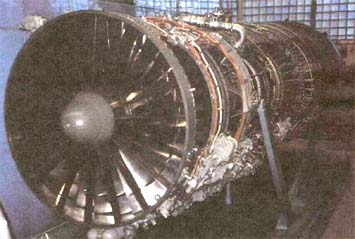

· القوة المحركة:
4 محركات من "جنرال الكتريك" من نوع (ف 101 ـ 100) مقواة بجذعين بدفع 13610 كجم.
