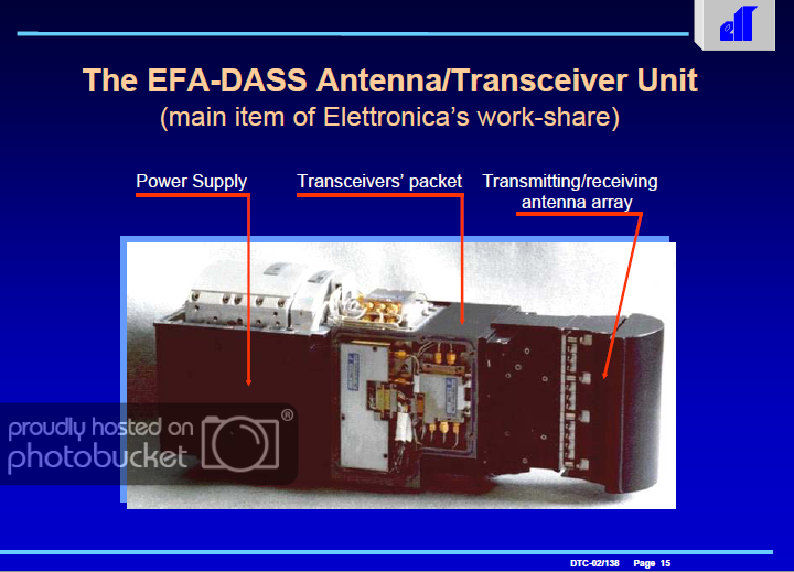

شركة elettronica الايطالية التي طورت الميراج الاماراتية والمصرية هي شريك في منظومة الحرب الالكترونية للمقاتلة يوروفايتر تايفون
An effective electronic protection system is an essential component of a modern fighter aircraft, since without this modern threat scenarios would not be used. The necessary equipment for the Eurofighter Typhoon - provided the consortium, which belong to EADS (Germany), BAE Systems (UK), Elettronica (Italy) and INDRA (Spain).
http://www.myaoc.org/282573D4-85A7-.../02CONV_Proceedings/Day2/Track2/Bacchelli.pdf
بالاضافة الي اعتبار تجهيراتها بديلة لتجهيزات الميج 35 ويمكن دمجها في الميج 29 المطورة
foreign partner is Elettronica S.p.A (ELT). Reportedly Bharat Electronics will be responsible for licence production of the system which will be based on Elettronica's Virgilius family of integrated RWR/SPJ. It's possible that 'Virgilius' is actually a marketing name for the ELT/568(v2) which would also equip the MiG-35. The number and type of antenna units looks to be identical and the placement of the antenna units on the MiG-35 airframe appears to match those seen on photos of the MiG-29 UPG test aircraft, with the only apparent difference being that they are more cleanly integrated on the MiG-35 airframe.
MiG-35 Forward Array mock-up.
Elettronica's Virgilius system, MiG-29UPG Forward Array mock-up shown lower left/right.
MiG-29UPG EW Suite components.
