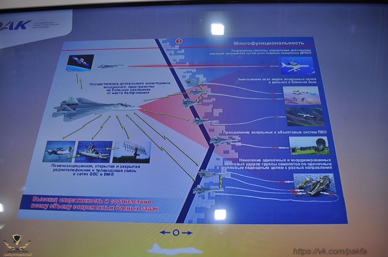

Since you have stated broadband sucks and that narrow band is better at a gain. Can transceivers like this limit their broad frequency scope to a narrow frequency? Why I also hinted the fga-35 (3d) is that its weight reduction as a radar from a previous AESA radar got drastically reduced by 1.5-2 times similar to the weight of the EW systems that got reduced by 1.5-2 times smaller being based with the same LTCC MMICs.
Current radar receivers cover like 1-18ghz give or take, GaN AESA based modules for EW systems have been told to cover UHF/VHF according to some Russian and US sources. So the next issue is photonic radars going up to 100ghz. Mikheeyev said the same multi-band radar technology can be found on the SU-57 when talking about ROFAR. So looking at the 1st image my focus is on the 17-100ghz tracking frequencies its more horrible than X-band but can be better than IRST around 300gh?.
ROFAR offers:
less internal noise. Higher frequencies than X-band suffer more internal noise but according to them these radars lower the noise inside the radar systems. Claims of immunity to EW. This seems to be true because if you are shooting for example 20ghz at another current 5th gen whose receivers can go up to 18ghz its not like they can suppress those waves.
