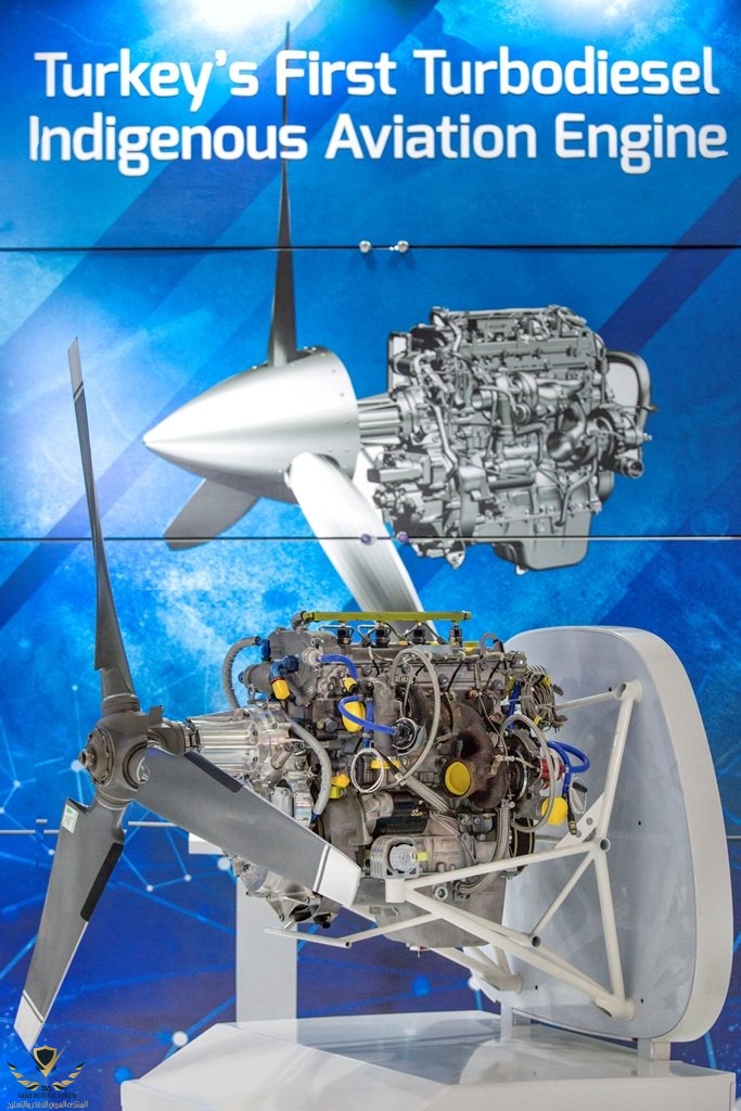

هو اي من المحركات سيركب علي هذة الطائرة ؟
أخر كلام هل هو Turbo shaft or Turbo diesel ؟
AKINCI Block-1 (2 x TEI PD-220 Turbodiesel engine)
AKINCI Block-2 (2 x TEI TP-550 Turboprop engine)

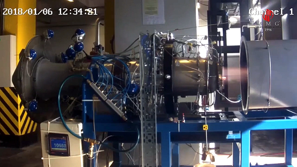

KALE ARGE KTJ3200 TURBOJET ENGINE
Type: Single Spool Turbojet
Major Applications: SOM ALCM Family and ATMACA Block I/II Missiles
Fully Functional Prototypes Delivery: Two prototypes in 2019
Length: ~ 70 cm
Diameter: 30 cm
Dry Weight: 48 kg
Specific Fuel Consumption (SFC): < or = 1.2 kg/daN/hr
Compressor: Various configurations have been studied during design phase including 4-stage axial, 5-stage axial and 1 axial and 1 radial compressor combination
Turbine: Single Stage
Fuel Type: JP8, JP10
Lubrication System: The bearing system is lubricated by fuel (on board the missile) rather than a separate oil system
Generator: Permanent magnet based 6kVA generator mounted on the engine shaft
Maximum Thrust: 3.2 kN (787 lbf)
Speed: Kale 3200 is designed to provide Mach 0.95 flight speed on SOM ALCM at a 5,000 ft altitude
Service Life: 17 hours
Running Time on SOM Missile: 20 to 25 minutes
First Test on a Test Bench at Laboratory: September 19, 2013

السلام عليكم
أخي محمد الفاتح جزاك الله خيرا
عندي سؤال بخصوص هذا المحرك هل هو مصمم ومصنع في تركيا بنسبة 100% ؟ و هل هو مخصص للصواريخ فقط ام سيكون منه اصدار للطائرات ؟
السلام عليكم
wa alaikum salam
yes, it is designed and developed by KALE ARGE with all its subsystems (including pyrotechnic igniter, ECU / electronic control unit, control software, fuel pump / fuel control system and alternator)
it is only for cruise missiles (SOM ALCM Family and ATMACA Block I/II Missiles)
-It's 4 cylinder 220kw ~ 300HP
-TUMOSAN 4 cylinder engines starting from 155HP up to 360HP
-TUMOSAN 6 cylinder versions of these engines are also available
