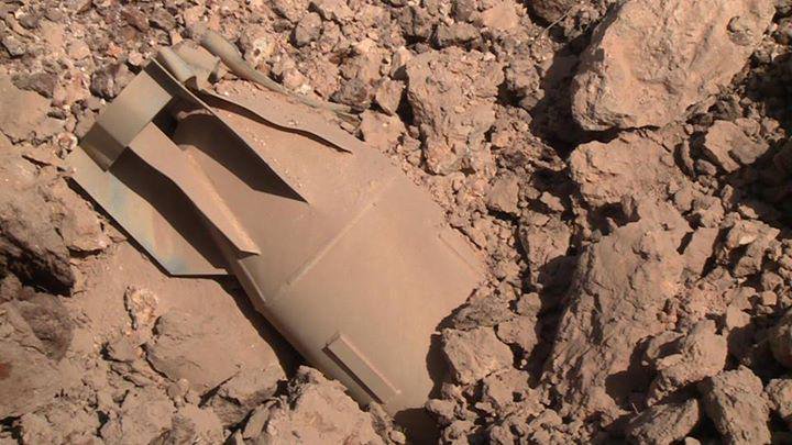

القنابل التي استعملت ضد هذه التجمعات هي BetAB-500 ShP او БЕТАБ 500 ШП وهي قنابل خارقة للتحصينات والخرسانة المسلحة Concrete Piercing bombs وهي تتميز كونها قنبلة شديدة التفجير High Explosive blast مخصصة لضرب التحصينات designed to penetrate re-enforced targets such as bunkers عن طريق الضغط العالي وتركيز قوة التفجير فوق منطقة الهدف ,,والية اسقاطها تتكون من براشوت ومحرك نفاث وهي من قنابل الاسقاط الحر وتصنف من فئة Parachute Retarded Bombs
The BetAB 500Sh P differs from the earlier BetAB 500 bomb in that it has a parachute retarding mechanism in the tail and a rocket motor.
When the bomb is dropped from the aircraft the parachute is deployed, at the same time igniting a short delay.
After a few second the delay element ignites the rocket motor which blows off the complete tail unit, (including the parachute) and drives the bomb into the ground (or hardened re-enforced target) where the inertia impact fuze functions after a delay of less than a second and causes the bomb to explode
