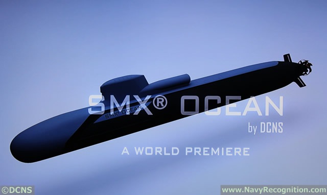

كشفت الشركة الفرنسية DCNS عن الغواصة الكونسبت في معرض يورونافال 2014
Exclusive: DCNS will unveil the SMX OCEAN at Euronaval 2014: A Conventional (SSK) Barracuda
Navy Recognition learned that DCNS will introduce a new submarine concept at Euronaval 2014 which be held from October 27th to 31st at Paris Le Bourget in France. The SMX OCEAN is based on a Barracuda hull, the next generation SSN of the French Navy, fitted with a conventional propulsion system (SSK) with AIP technology.
ستكون الغواصة مبنية على اساس بدن غواصة باراكودا .. وهي غواصة الجيل التالي للبحرية الفرنسية ..
سيتم تزويدها بنظام دفع تقليدي مع تقنية AIP
The SMX OCEAN concept to be unveiled at Euronaval 2014. Picture: DCNS
The focus of DCNS engineers in developing this concept was put on endurance and high sustained speed. We learned that the 4,700 tons SSK was designed for an endurance of 14,000 nautical miles (3 months autonomy) and a continuous transit speed of 14 knots for 1 week thanks to its Air Independent Propulsion (AIP) system fitted with two fuel cells. The original nuclear propulsion system of the Barracuda design was also replaced with six diesel engines and three sets of Li Ion batteries.
ازاحتها 4700 طن ومصممة لتبحر 14,000 ميل بحري ( 3 شهور ) وبسرعة مستمرة تبلغ 14 عقدة لاسبوع كامل .. وذلك يعود لنظام AIP المزود بخليتين وقود .
كذلك تم استبدال نظام الدفع النووي الاصلي للبراكودا بـ 6 محركات وعدد 3 مجموعات من بطاريات ليثيوم ايون .
Two thruster pods are deployable at the bottom of the hull to allow the submarine to maneuver while the main screw is not in action (full stop). The X rudder design is the same as on the Barracuda and allows increased maneuverability.
هناك دافعتان اسفل البدن تسمحان للغواصة بالمناورة كما ان لديها ذيل بشكل X ويعزز ذلك من مناورتها
The SMX OCEAN concept is fitted with an impressive load of up to 34 weapons for action in the four domains: anti-air, anti-surface, anti-submarine & action against land targets.
The SMX OCEAN SSK is fitted with one large modular VLS tube that may launch up to six MdCN vertically (much like the Virginia payload module developed by GDEB for the US Navy’s Virginia class of SSN). The submarine may also deploy F21 heavy torpedoes, SM39 Block 2 anti-ship missiles and a submarine launched version of the Mica missile (A3SM Underwater Vehicle Version) for self protection against air threats.
الغواصة مزودة بكمية مذهلة من التسليح تصل لعدد 34 سلاح في المجالات التالية ( مضاد للتهديدات الجوية , مضاد للقطع السطحية , مضاد للغواصات , مدمر للاهداف البرية )
الغواصة المحيط مزودة بموديول كبير لاطلاق رأسي والذي بمقدوره اطلاق عدد 6 صواريخ كروز من نوع سكالب البحري ( شبيه بالموديول المعتمد لغواصات فيرجينيا الامريكية ) .. كذلك يمكن ان تحمل الغواصة طوربيدات F21 الثقيلة , صواريخ SM39 Block2 المضادة للسفن اضافة لنسخة خاصة بالغواصات من الصاروخ الشهير ( ميكا ) يتم اطلاقها من تحت الماء للحماية من التهديدات الجوية .
Finally a DCNS representative told Navy Recognition that the SMX OCEAN may deploy and recover a new UUV DCNS is working on, as well as deploy a UAV acting as remote sensor for intelligence gathering.
افاد مندوب الشركة ان الغواصة المحيط يمكنها ان تطلق وتستعيد نظام تحت مائي غير مأهول اضافة لنشر طائرات UAV لتعمل بمثابة مستشعر لجمع المعلومات الاستخبارية .
