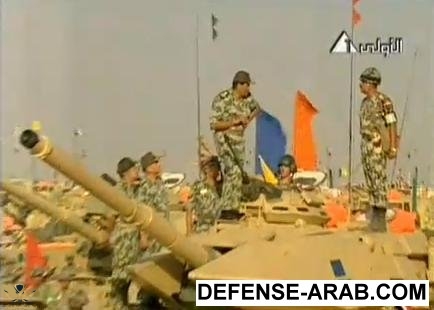

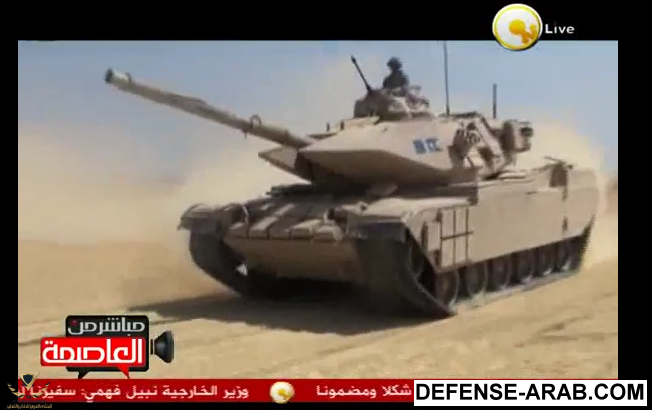

التطوير المصري الخاص بالدبابة M-60A3 يظهر اليوم أثناء زيارة الفريق أول / صدقي صبحي
هل يمكن أستبدال البرج بالكامل ببرج الروسية تي 72 بمدفع 120 !!!
أو يتم تصنيع برج منخفض مناسب لها في أوكرانيا ؟؟؟
صراحه اعدادها كبيرة ولابد من الأستفادة منها ولكن مدفع 105 عفى عليه الزمن ...

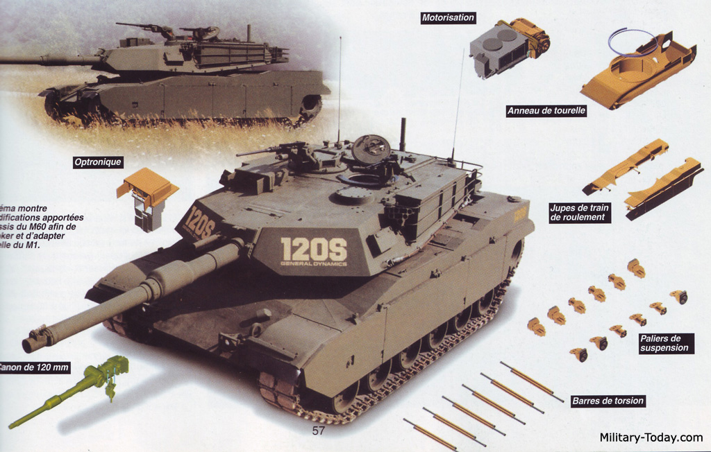

n short it’s the replacement of the M60A3 turret with the one used on the M1A1 Abrams MBT on an up-graded M60 hull. This means the operating country is equipped with a 120mm main cannon and a well armoured (composite) turret with a 240X4 Forward Looking Infrared Radar (AKA – FLIR) and is said to be half the price of purchasing an M1A1.
The hull is up-graded with a torsion bar suspension system as used on the M1A1, giving the tank greatly improved cross-country mobility and a stable base for fire on- the-move accuracy similar to the M1A1 tank. The hull can also be fitted with a number of different power packs, however GDLS, the developers of the up-grade package recommend that a AVDS-1790, which can generate 1200hp is used. The up-graded vehicle was developed to show the Turkish Army prior to the acceptance of the Sabre Mk.3 during the biding process at the opening ceremonies at IDEF 2001 in Ankara, Turkey.
Despite loosing out to the Turkish Army, the up-grade has been accepted by the Egyptian Army. They are scheduled to start the up-grades (they will be in kit form and completed by Egypt in the same facilities used to manufacture the Abrams kits) between 2009 to 2012. It’s expected that roughly 1000 of the current 1700 M60A3 fleet will be up-graded. They will also be fitted with a German engine in the 1500hp range.

اصبروا يجماعه الخير وما ادراكم انه التطوير النهائى فاعداد تلك الدبابه فى مصر ضخمه ويتم التطوير تدريجيا فما ادراكم بانه سيتم تطوير مخزون اخر بمدفع عيار 120 ..خصوصا اننا راينا دبابه واحده فقطططططط فى العرض بجانب العشرات من الدبابه الاساسيه بدون اى تطوير ....صبراااااااااااا

قامت مصر بالدخول في برنامج تطوير جديد للدبابة تحت اسم M60-2000/120-S من شركة جنرال ديناميكس الامريكية للمركبات (GDLS General Dynamics Land Systems) كالاتي :
- تطوير 1000 دبابة M60-A3 الى المعيار M60-2000.
- تغيير برج الدبابة بالبرج الخاص بالابرامز (M1-Abrams Turret).
- تغيير المدفع عيار 105 ملم بمدفع عاير 120 ملم الخاص بالابرامز.
- اضافة الدروع التفاعلية الخاصة بالابرامز مع تغطية جانبية للجنازير.
- اضافة نظام الكشف بالاشعة تحت الحمراء للبرج (FLIR Forward Looking Infrared Radar).
- نظام تعليق جديد لحفظ توازن الدبابة اثناء القصف واثناء عبور الموانع والعقبات.
- تغيير المحرك بآخر الماني بقوة 1500 حصان (اختيار مصري).
أعداد الــM60 في الجيش المصري 2130 دبابة
