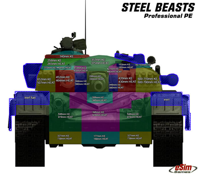

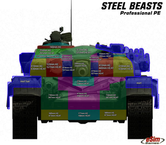

T-72B
Armour protection:
Frontal Turret Armour: ~520mm vs KE, ~600mm vs HEAT
Frontal Hull Armour: 190mm-400mm vs KE, 190mm-480mm vs HEAT

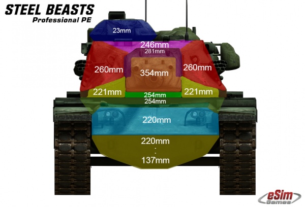

M60A3 TTS
Armour protection:
Frontal Turret Armour: ~224-280mm
Side Turret Armour: ~146mm
Front Hull Armour: ~214mm
Side Hull Armour: ~66mm

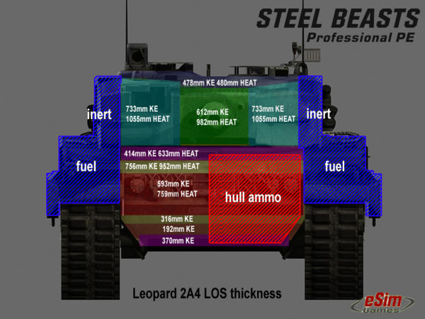

Leopard 2A4
Armour protection:
Frontal Turret Armour: 590-760mm KE, 810-1370mm HEAT
Frontal Hull Armour: 600mm KE, 710mm HEAT

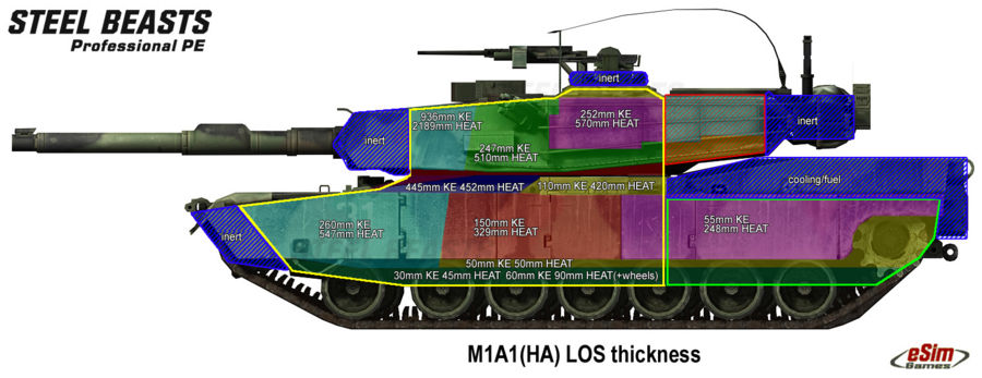

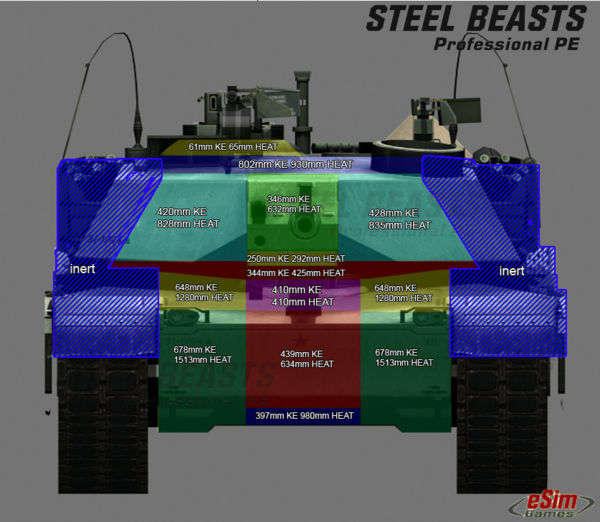

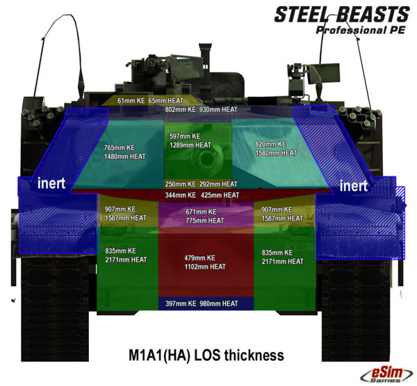

M1A1
Armor protection:
Frontal Turret Armor: 359mm-580mm vs KE, 896mm-1220mm vs HEAT
Frontal Hull Armor: 125mm-390mm vs KE, 285mm-910mm vs HEAT

M1A2
Armour protection:
Frontal Turret Armour: 522mm-~780mm vs KE, 896mm-1220mm vs HEAT
Frontal Hull Armour: 125mm-~490mm vs KE, 285mm-910mm vs HEAT

T-72M
Armour protection is 'similar' to T-72 Ural:
Frontal Turret Armour: 280mm-390mm vs KE, 360mm-570mm vs HEAT
(SB documentation)
رد: تدريع دبابات المعركة الرئيسية

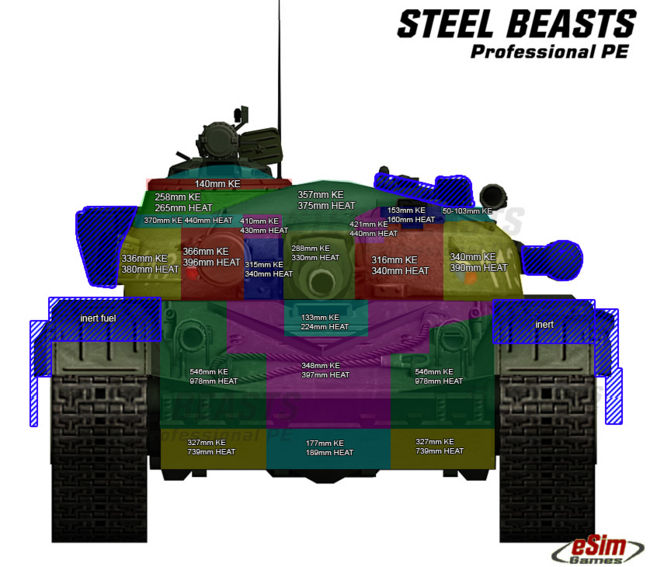

T-72M1
Armour protection is 'similar' to T-72A:
Frontal Turret Armour: 280mm-450mm vs KE, 360mm-570mm vs HEAT

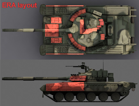

T-80U
Armour protection:
Frontal Turret Armour: 350mm-680mm vs KE, 560mm-1140mm vs HEAT
Frontal Hull Armour: 240mm-720mm vs KE, 380mm-1040mm vs HEAT
