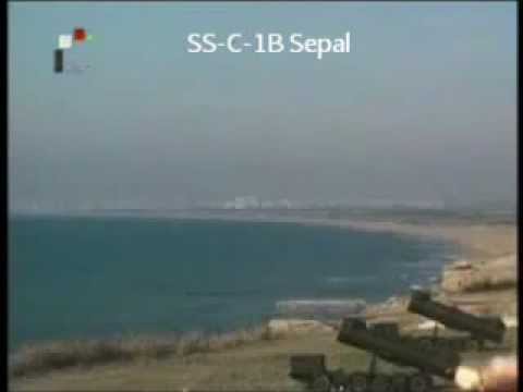

صورة الصاروخ في تدريبات البحرية السورية :

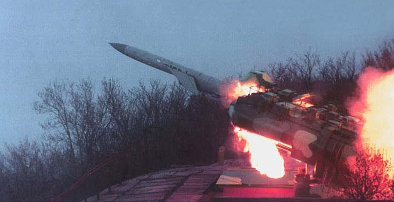

SPU-35B / SSC-1 Sepal TEL launching (via Russian Internet).
A pair of SPU-35B / SSC-1 Sepal TELs launching (via Russian Internet).

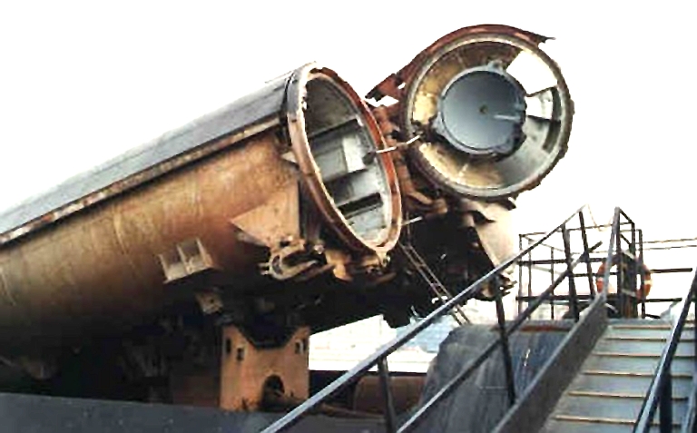

SPU-35B / SSC-1 Sepal TEL launch tube (via Russian Internet).

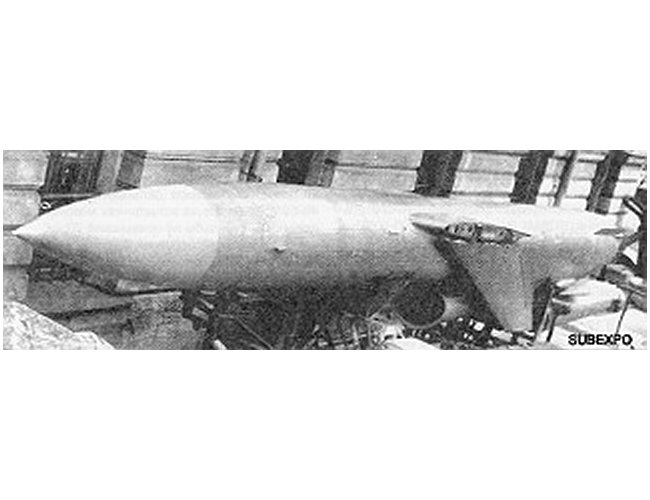

P-5/4K48 / P-6/4K44/ P-35/4K88 / SS-N-3 / SSC-1 Sepal/Shaddock
The first Shaddock variant to enter service was the P-5 / 4K48 variant in 1959, soon followed by the improved P-35 / 4K44 variant, with the P-6 / 4K88 entering service during the eartly 1960s. The Shaddock was a large 10 metre long, 4.5 tonne launch weight, turbojet powered ASCM, with a cruise speed of Mach 1.5 and range of around 200 nautical miles. This massive ASCM was armed either with a 2,000 lb class conventional shaped charge 4G48 warhead or a 350 kilotonne nuclear warhead. A TRD 4D48 turbojet was used, with a pair of 66 klb thrust solid rocket boosters for launch.
The P-35 Shaddock used programmable midcourse cruise profiles, at altitudes of 1300 ft, 13 kft or 23 kft AMSL, with radar guided terminal phase at an altitude of around 300 ft AMSL. The lowest altitude midcourse profile reduced range to around 55 nautical miles.
The Shaddock was initially deployed on Project 58 Grozny and then Project 1134 Sevastopol class cruisers, and by the mid 1960s also on the Project 651 Echo SSGN and 675 Juliet SSGs, these submarines needing to surface in order to raise the large launchers.
The Shaddock used a complex guidance scheme, relying on datalink support during the midcourse profile, with the cruise altitude determined largely by the need to maintain line of sight to the launch vessel.
After launch the Shaddock would climb to cruise altitude following datalink steering commands, with the missile’s position tracked using a beacon transponder by the Front Door/Front Piece radars (SSG/SSGN) or Scoop Pair (DDG/FFG). Once the Shaddock had line of sight to the target, a video datalink was engaged which relayed the seeker image to an operator on the launch vessel. The operator would select the intended target and use the datalink to lock the seeker on that target. The missile would then transition to terminal homing and descend to impact, losing datalink contact as it fell below the radio horizon. Modes for attacking coastal targets were included.

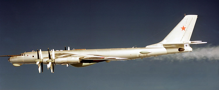

Over the horizon targeting required an airborne surveillance and acquisition system, which was implemented with X-band radar, the large MTsRS-1 Uspekh / Big Bulge carried by the Tupolev Tu-95RTs Bear D maritime reconnaissance and targeting aircraft. The Kamov Ka-25RTs Hormone B helicopter carried a scaled down variant of the radar and were used to provide organic targeting capability on larger warships which deployed this helicopter.
During this period the Soviets developed tactics for saturation ASCM attacks, with multiple submarines or cruisers positioning for launches and using targeting outputs from the Bear D. The principal drawback of the Shaddock was that it required submarines remained surfaced for up to 30 or more minutes until the Shaddock seekers lit up, a major vulnerability. The heavy dependence on datalinks also provided opportunities for jamming​
Tu-95RTs Bear D targeting platform. Note the large radome for the bomb bay mounted MTsRS-1 Uspehkh / Big Bulge surface search and ASCM targeting radar, and the ESM antennas for passive ASCM targeting on the aft fuselage (US DoD).

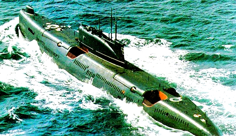

Echo I SSGN (US DoD).
Juliet SSG (US DoD).
