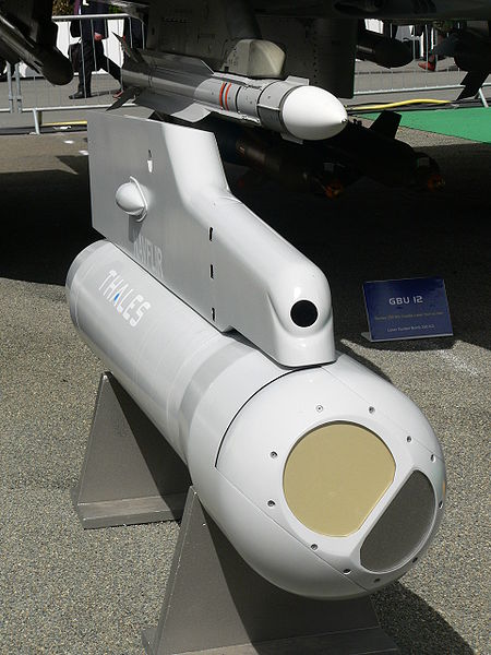

Rafale pilots are already able to measure the distance between their intended target and bystanders thanks to the imagery provided by their Damoclès laser designator pod, and can thus see whether there is a risk of collateral damage before firing. This is not enough, however, and a joint defense staff/DGA working group is looking at alternatives, one of which is the off-the-shelf procurement of the Brimstone guided missile (a much-modified variant of the Hellfire) developed and produced by MBDA.

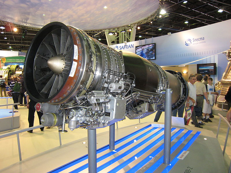

M-88 Engines: to Uprate or Not to Uprate?
An engine upgrade, however, is not on the cards for the Rafales operated by the French forces, which consider that the Snecma M-88’s current 7.5-tonne power rating is enough.
Given Rafale’s two engines, available power is 15 tonnes, which given the aircraft’s empty of 10 tonnes translates into a power-to-weight ratio of 1:1 with 50% fuel and 2.5 tonnes of weapons. Admittedly, this ratio degrades quickly if the aircraft is loaded to its maximum take-off weight of 25 tonnes, (including 5 tonnes of internal fuel and 10 tonnes of weapons), but then again this is not a typical configuration for air-to-air combat.
French air force pilots interviewed at Solenzara say that the current engine power allows them to fly all of their missions without limitations, and that on a seven-hour mission to Libya they can cruise at Mach 0.9 on a 50% power setting with a full ordnance load. They also say that operations in the United Arab Emirates, Afghanistan or other high-temperature areas have not shown a real need for more power, although they all agree that it would be nice to have.
One Rafale pilot at Solenzara who has flown in the UAE remarked that one reason they want a more powerful engine is that its pilots are now used to the latest F-16 Block 60, which is essentially a small airframe built around a very big engine, and so find the Rafale underpowered by comparison.
Another reason for a 9-tonne engine, a source said June 6, is that the UAE want to carry three Black Shahine cruise missiles and three 2,000 liter drop tanks, where the French air force carries only two similar Scalp-ER missiles, each of which weighs 1,300 kg. “It’s clear that, when taking off with such a payload in very hot weather” – and in the Emirates temperatures can reach 50 degrees Celsius – “it’s better to take off with 18 tonnes of thrust than 15.”
While the 9-tonne engine is mooted for export, DGA’s Rebb said that “no decision has been taken on a more powerful engine for France,” adding that the ultimate decision “will depend in great part on costs.”
Work on an improved M-88-2E4 engine is well advanced at Snecma, but the goal is not to increase power but to lower the Total Cost of Ownership (TCO) by extending service life and time between inspections. The -2E4 will also reduce fuel burn by 2 to 4%, Snecma says.
The improvements included in the -2E4 engine will form “a large part” of the future 9-tonne engine. However, notes a Dassault Aviation executive, there’s a big stumbling block: “we need an order and a signature to launch the 9-tonne engine.”
Meanwhile, the M-88-2E4 is due to complete its flight test program this month and to be delivered for production aircraft from next November. Main improvements include a new high-pressure turbine and a new three-stage HP compressor, with the goal of improving HP turbine life by 30%.
The approach selected for the -2E4 development means that new parts can be added to existing engines, independently of each other, as old ones need replacing, so implementing the TCO upgrade will be a gradual and low-cost process.

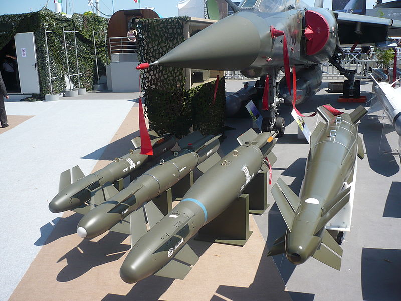

Finally, DGA is also completing in-flight evaluation of the latest, laser-guided version of the Armement Air-Sol Modulaire (AASM, or “Hammer”) developed by Sagem. Integration onto the Rafale has been completed, and three test firings, including one against a target moving at a speed of 80 km/h (50 mph), have successfully completed the development phase. In this case, the AASM was fired at an off-axis angle of 90 degrees against a fast-moving laser spot generated by a ground-based illuminator, but DGA has scheduled another three test firings against representative targets in 2012 before the weapon enters service. Full-scale production of the laser-guided AASM is due to begin in late 2012.

طيار الرافال يستطيع تحديد الهدف بدقه من خلال الصور المتاحه له
من البود Damoclès laser designator pod وبذلك يستطيع ضرب
الهدف مع تقليل الخسائر الجانبيه

بالنسبه للمحرك M-88 Engines
ترقيه المحرك ليست مطروحه وذلك لأن القوات الجويه الفرنسيه ترى إنه مناسب
خاصة إن المقاتله ثنائية المحرك
ويقول الطيارين الفرنسيين إن المحرك كافى وغنهم طارو من فرنسا إلى ليبيا فى رحله إستغرقت
7 ساعات على سرعه cruise at Mach 0.9
كما إن الطائره تعمل بكفأه فى الإمارات وأفغانستان فى درجة حراره عاليه
ولكنهم إتفقو إنه من الجيد لو تم ترقية المحرك
وقال أحد طيارى الرافال إن الإمارات تريد محرك أقوى لأن لديه محرك F-16 Block 60
وهو محرك قوى يعمل على طائره ذات هيكل خفيف بعكس الرافال
وقال مصدر أخر إن الإمارات تريد المحرك أقوى لأنها تريد تحميل الرافال
3 صواريخ Black Shahine cruise missiles و3 خزانات وقود بسعة 2000 لتر
ويذكر أن مقاتلات سلاح الجو الفرنسى تحمل صاروخان من طراز Scalp-ER missiles
وهو نسخه مصغره يزن الواحد 1300كجم
كما إن درجة الحراره المرتفعه فى الإمارات يجعلها تحتاج لمحرك قوى
والمحرك القوى بقوة دفع 18 طن يجرى مباحثات لتصديره لكنه غير مطروح للقوات الجويه الفرنسيه
والعمل على تطوير المحرك M-88-2E4 يجرى العمل عليه
حيث إنه سيقلل من إستهلاك الوقود وخفض التكلفه وتمديد عمر المحرك
ومن المقرر أن يتم إختباره هذا الشهر ويتم تسليمه لتركيبه على المقاتلات فى نوفمبر القادم
وتشمل التحسينات كمبروسور ذو 3 مراحل وتوربينات جديده يزيد عمرها بنسبة 30%
والنهج المصمم عليه المحرك عباره عن أجزاء تضاف إلى بعضها البعض
وعند الحاجه لإستبدال قطعه ما أو صيانتها يمكن إخراجها بمفرده مما يقلل فى الوقت والتكلفه

وسيتم تحميل القنابل الموجهه بالليزر (AASM, or “Hammer”) من إنتاج ساجيم
التى تم دمجها على الرافال وإختبرت ثلاثة مرات ضد هدف متحرك بسرعة 80كم
وسيجرى إختبارها ثلاثة مرات فى عام 2012
