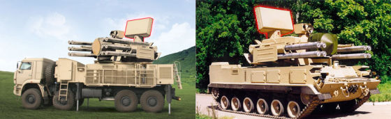

tracked+wheeled+Pantsir+Pantsyr+S1+SA-22+Greyhound+air+defense+missile+gun+system+%2528Russian+%25D0%259F%25D0%25B0%25D0%25BD%25D1%2586%25D0%25B8%25D1%2580%25D1%258C+57E6+or+57E6-E+solidshort+to+medium+range+surface-to-air+missile++2A38M+30+mm+autocannon+guns++EHF+AESA+PESA+UAE+IRAN+%25282%2529.jpg
