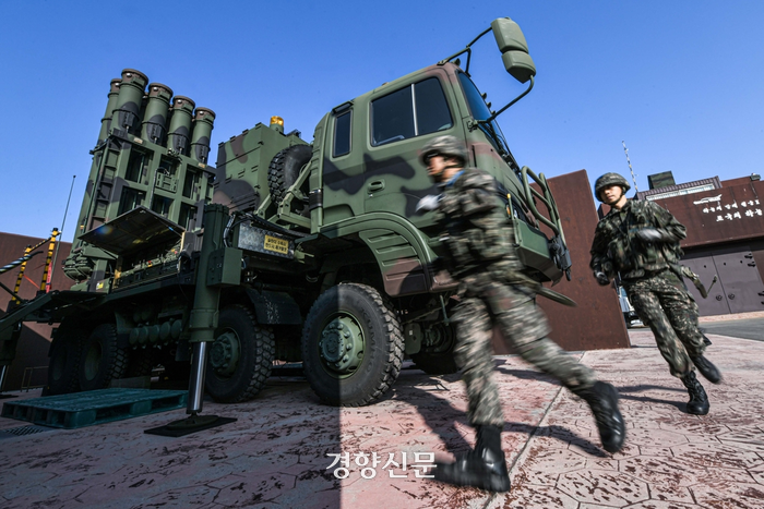

The South Korean LIG Nex1 aerospace and defense company displays at IDEX 2021 its Medium-range Surface-to-Air Missile M-SAM II, also known as Cheongung II. (Picture source ADS)
In November 2021, Army Recognition has reported that the United Arab Emirates will purchase South Korean air defense missile systems Cheongung II also called M-SAM. On Tuesday, November 16, 2021, United Arab Emirates (UAE) defense ministry had announced the acquisition of the latest generation of South Korean-made M-SAM medium-range surface-to-air guided missile system via the Tawazun Economic Council. The amount of the contract could reach a value of $3.5 billion.
In recent years, South Korea has intensified its diplomatic relations with the UAE, and strengthened their cooperation in the military field. South Korea also agreed to transfer unmanned aerial vehicles and other technologies to the UAE through a partnership between Abu Dhabi-based Calidus and Korean Air. With South Korea announcing enhanced defense investment in developing drones and lasers in future, the Gulf markets are a natural business opportunity.
The Cheongung 2 also named KM-SAM is a South Korean medium-range surface-to-air missile (SAM) system that was developed by the South Korean Agency for Defense Development (ADD) with technical support from Almaz-Antey and Fakel, based on technology from the Russian-made 9M96 missile used with the S-350E and S-400 air defense systems.

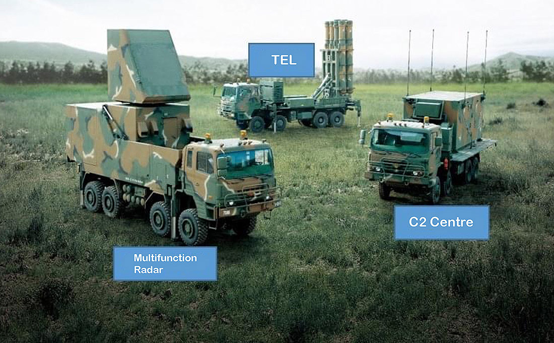

A complete battery of Cheongung 2 consists of up to six 8-cell transporter erector launchers (TELs), a passive electronically scanned array (PESA) X-band multi-function phased array 3D radar (based on the one from the Russian S-400), and a fire command vehicle. The radar operates in the X-band and rotates at a rate of 40 rpm, covering up to 80 degrees in elevation. It can detect targets within 100 km and track up to 40 simultaneously. The Cheongung SAM system is intended to replace South Korea's MIM-23 HAWK SAM systems, which are locally referred to as Cheolmae.
The KM-SAM can intercept up to six targets simultaneously, and the missiles have anti-electronic warfare capabilities to keep functioning despite jamming. It can intercept targets up to an altitude of 15 km at a range of 40 km.

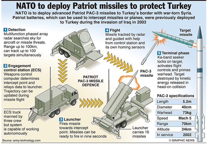

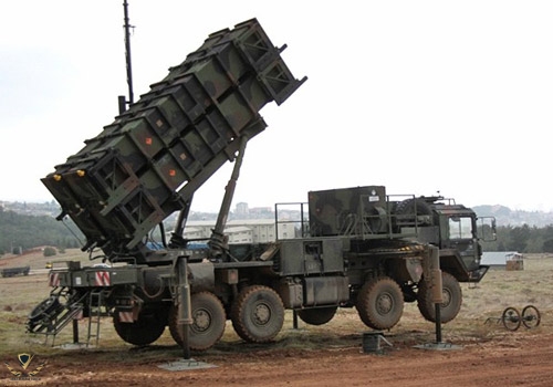

اجزاء المنظومة توفر حركية عالية (لست متأكدا ان كان البلوك 2) لكن بالبناء عليه وتطويره .. ستكون ميزة حركية اجزاء النظام العالية اضافة رائعة
كل الاجزاء محمولة على عربات .. اما الباتريوت بالمقارنة
الرادار مقطور ..
الرادار مقطور ..

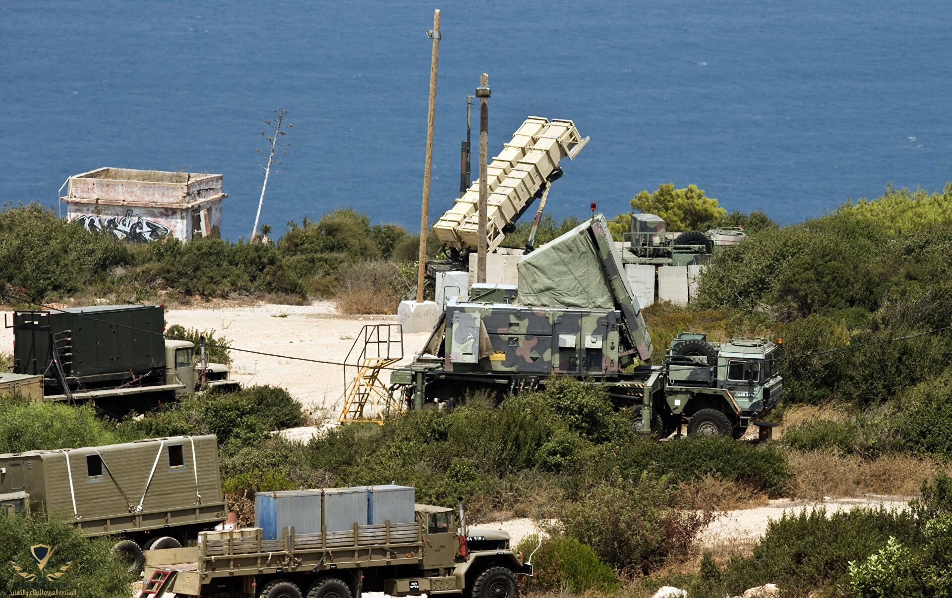

مب شرط هذا يعتمد على متطلبات الدولة، ممكن يكون الباتريوت محمول على شاحنات ومتنقل وممكن يكون مقطور

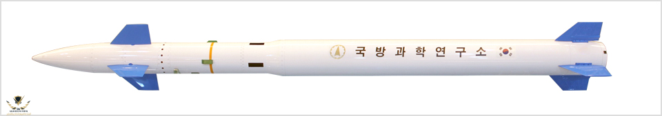

برنامج ترقية Chelomae-II ، المرحلة 2
يهدف هذا البرنامج إلى ترقية بطاريات Cheongung-I (KM-SAM Block-I) الحالية إلى Cheongung-II (KM-SAM Block-II) بين عامي 2023 و 2029 بتكلفة 500 مليون دولار. تجري دراسة الجدوى للإنتاج القادم ومن أجل تلبية الطلب التشغيلي للدفاع الجوي والصاروخي الكوري (KAMD) ، يجب الموافقة على الميزانية بحلول عام 2023. في حالة الموافقة ، سيتم منح عقد إنتاج المرحلة الثانية للشركة المصنعة في يونيو 2023.

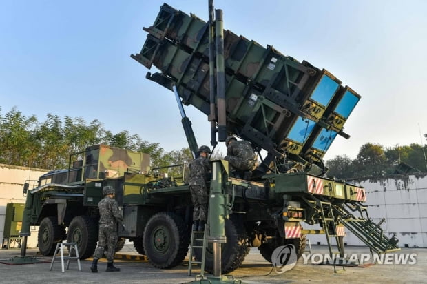

في تمرين بالذخيرة الحية أجرته القوات الجوية في اليوم الثاني ، تبين أن الصواريخ مثل Cheongung و Patriot لم يتم إطلاقها بشكل طبيعي.
وفقًا للسلطات العسكرية في اليوم الثالث ، أجرى سلاح الجو "مسابقة إطلاق الصواريخ الموجهة لعام 2022" في ميدان دايتشيون للرماية في بوريونغ سي ، تشونغتشونغنام-دو في اليوم السابق للتحقق من المهارات وتحسين القوة القتالية.
تم إجراء المسابقة بإسقاط هدف غير مأهول يحاكي تهديدًا جويًا افتراضيًا للعدو بصاروخ موجه حقيقي.
ونتيجة للتأكيد ، فشل إطلاق الصاروخ الكوري أرض - جو متوسط المدى "تشونغونغ". احترقت طلقة واحدة من طراز Cheongung لمدة 10 ثوانٍ تقريبًا بعد الإطلاق ، واستهلكت كل وقودها ، وانفجرت بعد الطيران لمسافة 25 كم في البحر.
وقال مسؤول عسكري: "في المرحلة المتوسطة ، يجب أن يستمر الاتصال بين الصاروخ الموجه ورادار السيطرة على النار، لكن تشير التقديرات إلى أنه غير مستقر".
وتابع ، "يقوم معهد أبحاث علوم الدفاع (ADD) والشركة المصنعة بتحليل سبب الانفجار وضعف التواصل مع القصر السماوي".
قال الجيش إنه منذ أن تم تزويد تشونغونغ بالكهرباء في عام 2017 ، كانت جميع عمليات الإطلاق الـ 17 ناجحة حتى العام الماضي ، وهذا هو الفشل الأول.
تم العثور على سلاح موجه بعيد المدى ، صاروخ باتريوت الاعتراضي ، معيبًا أيضًا.
تم الإطلاق الأول لصاروخ باتريوت بشكل طبيعي ، لكن تم إلغاء إطلاق صاروخ باتريوت ، المقرر إطلاقه الثاني ، بسبب خطأ في قطع الإشارة في رادار نظام التحكم في النار.
وأوضح مسؤول عسكري أن "هذه المسابقة ذات مغزى لاستكمالها من خلال فحوصات المهارة ، لذلك تم إلغاؤها على الفور مراعاة لغرض المنافسة وسلامتها.
يخطط الجيش للمضي قدما في مسابقة الرماية المتبقية المقرر إجراؤها في 9th بمجرد التأكد من عدم وجود مشكلة في السلامة في المستقبل.
سيحضر حدث هذا العام 180 موظفًا تشغيليًا من بطاريتي باتريوت و 4 بطاريات تشونغونغ تحت قيادة الدفاع الصاروخي.
