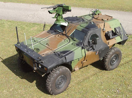

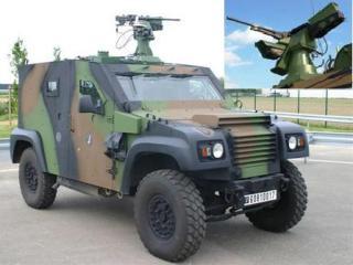

صور اخرى للنظام ( تطوير ساجيم وسافران الاصلي )
من صفحة المنتج في شركة ساجيم و سافران
WASP, a remotely-controlled turret for up to 7.62-mm calibermachine guns, offers an innovative day/night self-protection solution for light armored vehicles and trucks with armored cabs. Available in several versions, WASP can incorporate a range of optronics equipment: day and thermal sight SWORD T&D from the dismounted soldier equipment (FELIN program) or the CM3 multifunction camera. Combining a daytime channel, thermal channel and laser rangefinder, the CM3 camera offers higher observation capabilities to the weapon range, thus providing WASP turrets with a real surveillance function. WASP’s wide elevation axis makes it especially efficient in urban combat zones.
- See more at: http://www.sagem.com/spip.php?rubrique97#sthash.iYPoV7Gy.dpuf
مواصفات تقنية مقتبسة من ملف PDF للمنتج
