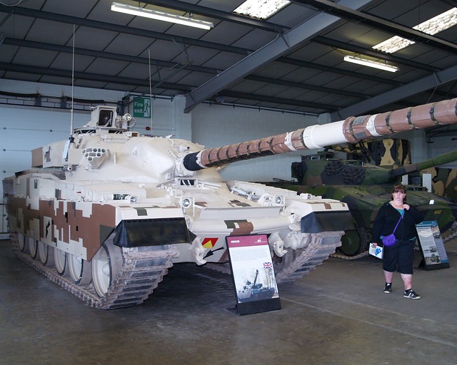

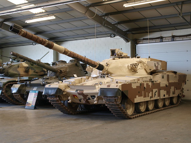

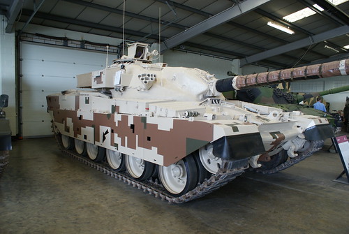

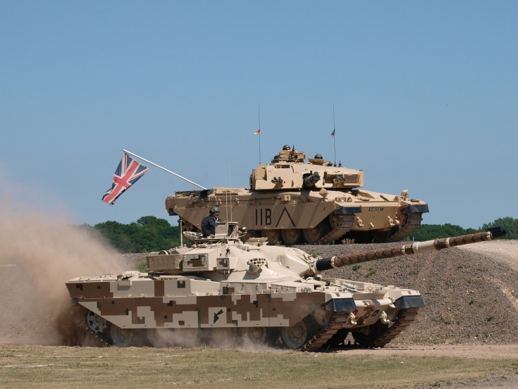

Specifications
Property
Value
Crew
4
Weight (kg)
58000
Power-to-weight ratio (h.p./t)
20.68
Ground pressure (kg/sm2)
0.9
Length (mm)
11550
Width (mm)
3518
Height (mm)
2975
Ground clearance (mm)
508
Track (mm)
2770
Track link width (mm)
650
Length of track on ground (mm)
4965
Max. road speed (km/h)
56
Fuel capacity (l)
950
Max. road range (km)
400
Gradient (%)
60
Side slope (%)
30
Vertical obstacle (mm)
914
Trench (mm)
3149
Engine power output (h.p.)
1200
Main weapon caliber (mm)
120
Auxiliary gun calibre (mm)
7.62
AA gun caliber (mm)
7.62
Number of smoke grenade launchers
12
Ammunition of the main gun
64
Ammunition of the auxiliary gun
6000
Traverse arc (degree)
360
Elevation (degree)
20
Depression (degree)
-10
Planes of gun stabilization
2
Laser range finder
1
Has folowing part:
Part
Amount
CV-12 1000 (Diesel engine)
1
L11 (Gun)
1
L8A2 (Machine gun)
1
TN37 (Transmission)
1
Khalid Quantities:
Country
Quantity
JORDAN
350
Total:
350​

صور رائعة فعلا
