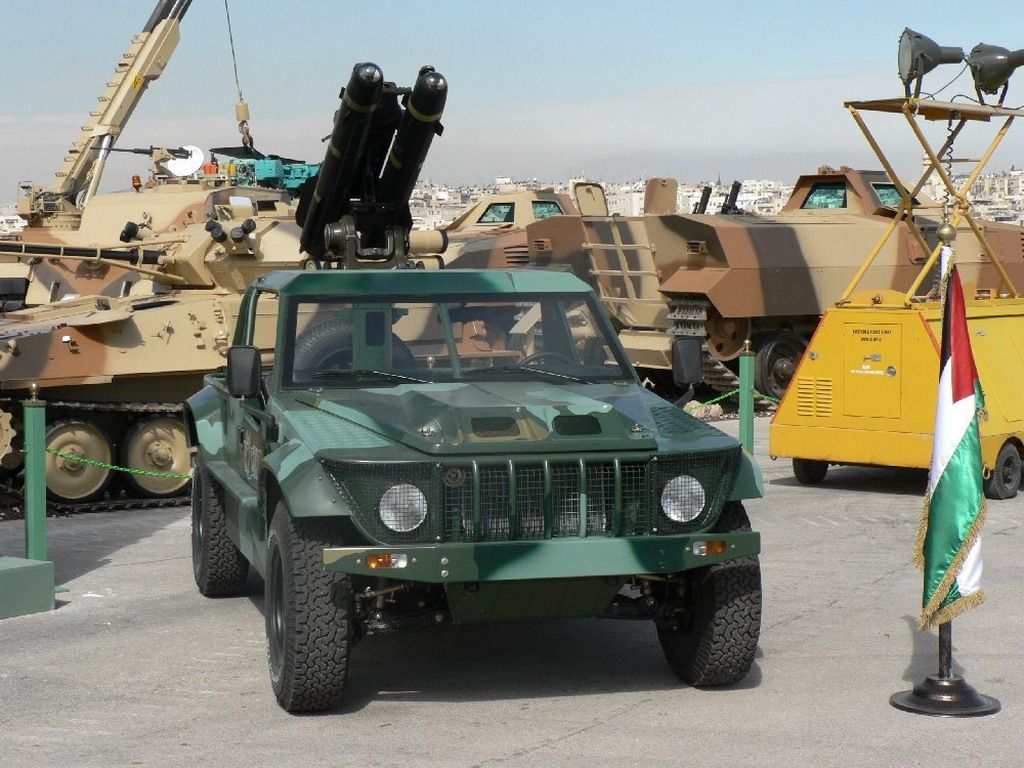

sofex_2006_Special_forces_operations_defence_exhibition_Al-Hussein_Challenger_1_002.jpg
sofex_2006_Special_forces_operations_defence_exhibition_Desert_Iris_twin_Hellfire_launcher.jpg
