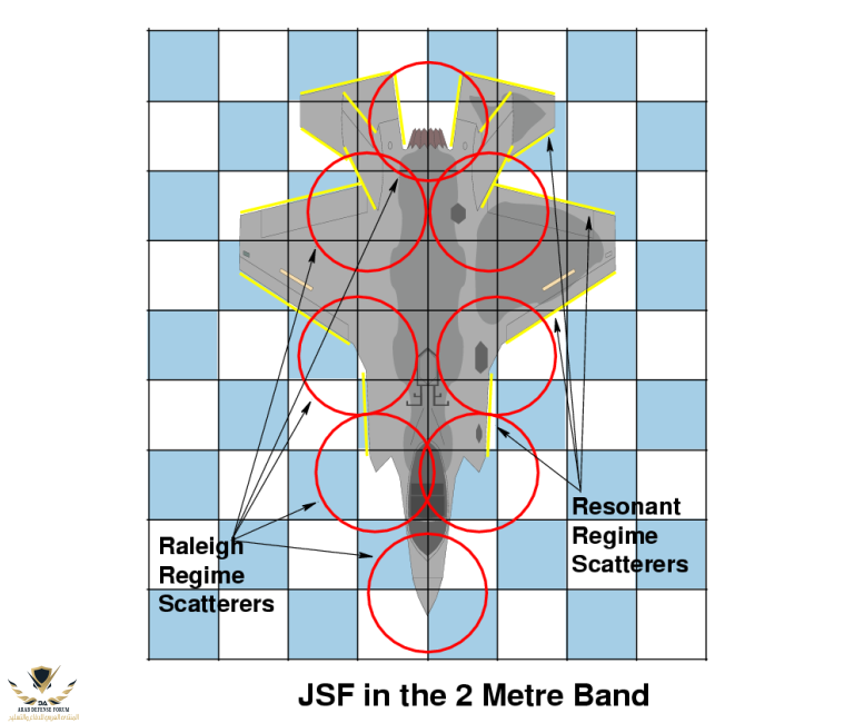

ليكن في علمك حاليا B-2 الطائرة الوحيدة التي تمتلك RAM أكثر كفائة ضد vhf-band هل تعلم لماذا ؟ هل تعلم كم عرض و سمك ram في مقدمة b-2 ضد vhf-bnad ؟ عندما تجيب عن هذه الاسئلة ساستمر في نقاشك .. مع كل ماذكرت يمكن رصد b-2 بواسطة رادارات vhf خاصة مع تعديلات على هوائياتها و الكترونياتها و برمجياتها سيكون المدى أقل لكن أفضل من لا شيئ
تفضل اقرأ قليلا ... العالم كامل يعرف هذا عن اف22 و اف35 إلا هنا في هذا المنتدى

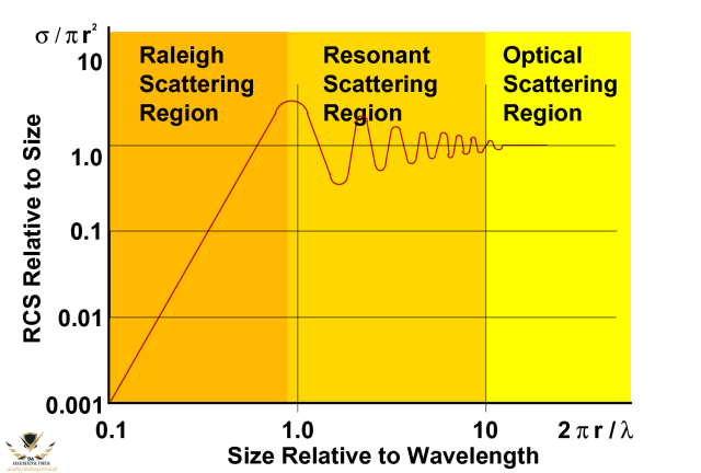

These are correct observations. The shaping features of US stealth fighters are dimensionally such that they fall into the resonance and Raleigh scattering regimes for VHF band radars, where shape has little impact on the Radar Cross Section. Their observations on skin depth are also correct, as resistive and lossy materials always exhibit greater skin depth than conductors such as aluminium skins.
So a fighter with stealth design features faces an interesting challenge when confronting a VHF band radar. Most of the carefully faceted, serrated and blended shaping features so effective at beating decimetric and centimetric band radars will appear as blobs to a VHF radar and reflect across a wide range of angles, losing their capability to scatter impinging radiation away from the radar illuminating the aircraft. The shaping of the planform is also less than entirely effective, unless it is very disciplined in the manner of the Northrop YF-23A or B-2A designs.

For instance, let us consider the F-35 JSF in the 2 metre band favoured by Russian VHF radar designers. From a planform shaping perspective, it is immediately apparent that the nose, inlets, nozzle and junctions between fuselage, wing and stabs will present as Raleigh regime scattering centres, since the shaping features are smaller than a wavelength. Most of the straight edges are 1.5 to two wavelengths in size, putting them firmly in the resonance regime of scattering. Size simply precludes the possibility that this airframe can neatly reflect impinging 2 metre band radiation away in a well controlled fashion.
The only viable mechanism for reducing the VHF band signature is therefore in materials, especially materials which can strongly attenuate the induced electrical currents in the skins and leading edges. The physics of the skin effect show that the skin depth is minimised by materials which have strong magnetic properties. The unclassified literature is replete with magnetic absorber materials which have reasonable attenuation performance at VHF band, but are very dense, and materials which require significant depth to be effective if lightweight. The problem the JSF has is that it cannot easily carry many hundreds of pounds of low band absorber materials in an airframe with borderline aerodynamic performance. Some technologies, such as laminated photonic surface structures might be viable for skins, but the experimental work shows best effect in the decimetric and centimetric bands. Thickness again becomes an issue.
The reality is that in conventional decimetric to centimetric radar band low observable design, shaping accounts for the first 10 to 100 fold reduction in signature, and materials are used to gain the remainder of the signature reduction effect. In the VHF band shaping in fighter sized aircraft is largely ineffective, requiring absorbent materials with 10 to 100 fold better performance than materials currently in use. In the world of materials, getting twice the performance out of a new material is considered good, getting fivefold performance exceptional, and getting 100 fold better performance requires some fundamental breakthrough in physics.
