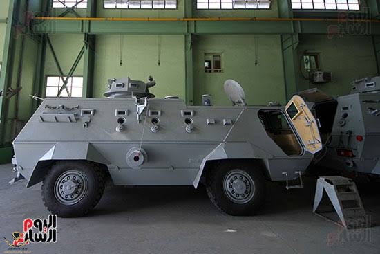

فهد 240
فهد 240 recovery and repair variant
فهد للإسعاف
فهد لزرع الألغام
فهد مركبة قيادة
The Fahd command vehicle contains three gun mounts for 7.62 mm caliber machine guns, as well as other special equipments for command purposes.[7]
Fahd 280 w/ BTM-208 Turret
فهد لمكافحة الشغب
The Anti-Riot variant is based on the Fahd 280. The dual weapons installed in the turret are replaced with a water cannon actuated at 180L/min pump to jet plain, colored or mixed water at a distance of 30-50m. Grenade launchers are also installed on the turret for firing smoke and tear gas grenades. There is a steel grader in the vehicle front to remove barricades in streets and passes, along with two flashers, multi-tone siren, loud speaker and horn. This variant also has a passenger capacity of ten.[17]
فهد 280-30
The Fahd 280-30 is an IFV variant of the Fahd, first announced in 1990.[18] It features a BMP-2 turret on the roof of the passenger compartment near the rear. It has a 30 mm automatic cannon with an effective range of up to 1500 metres against armor, 2500 metres against ground targets, and 3,000 metres against air targets. It has a dual feed, one for HE rounds, the other for AP rounds, which can pierce 18 mm armor at 60 degrees from a range of 500 m. It also has a coaxial 7.62 mm PKT machine gun and an ATGM launcher, capable of launching AT-4 or AT-5 missiles which use SACLOS guidance, increasing the range at which the Fahd 280-30 can engange armored targets such as tanks to nearly 4000 m. These turret-mounted missiles may be deployed away from the vehicle on a launching tripod. The Fahd-30 carries 500 30 mm rounds for the autocannon, 2,000 rounds for the 7.62 mm machine gun, and five AT-5 missiles. Smoke grenade launchers are standard on this vehicle, with four on each side of the turret. The BMP-2 turret may use appliqué armor. In terms of design it is similar to the Fahd 240, but this variant has three firing ports on each side of the vehicle.[17]

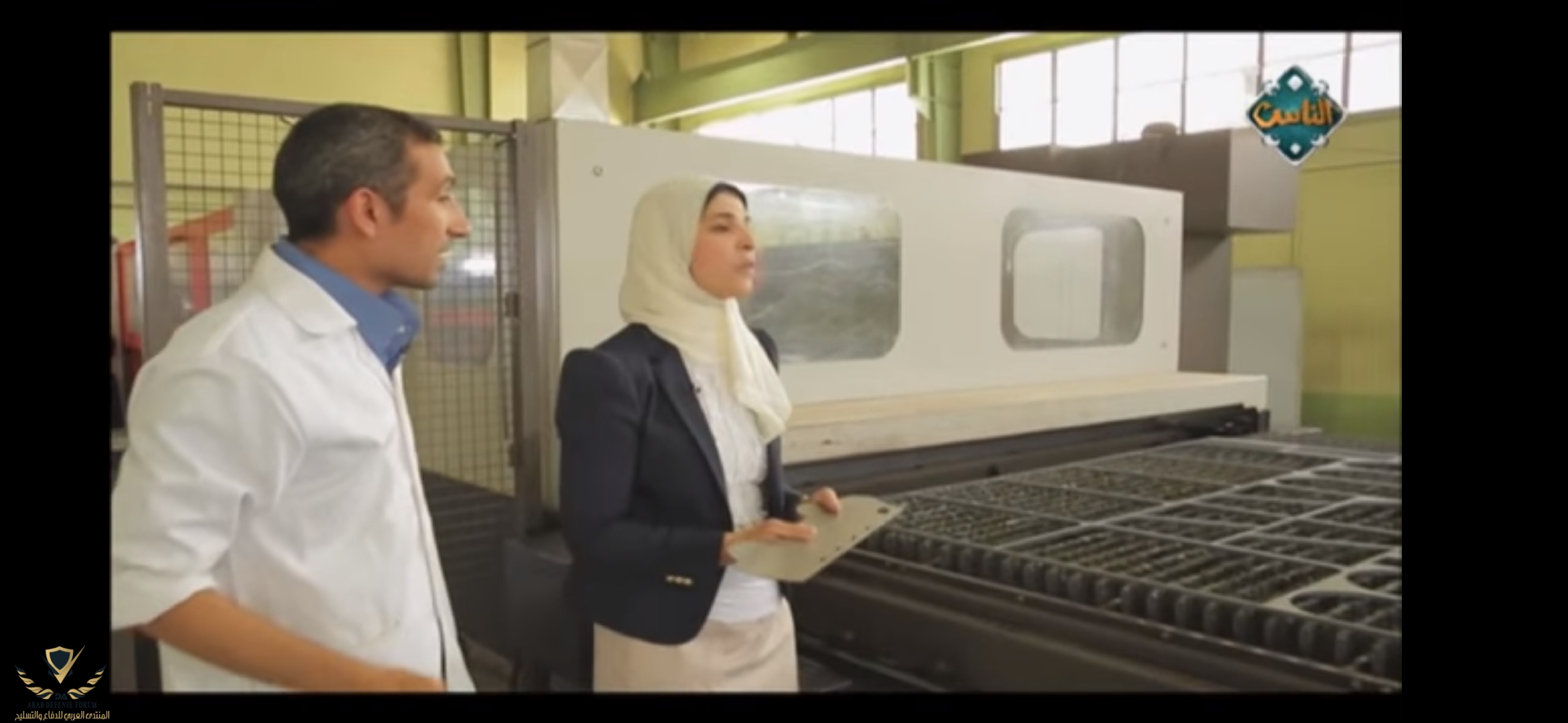

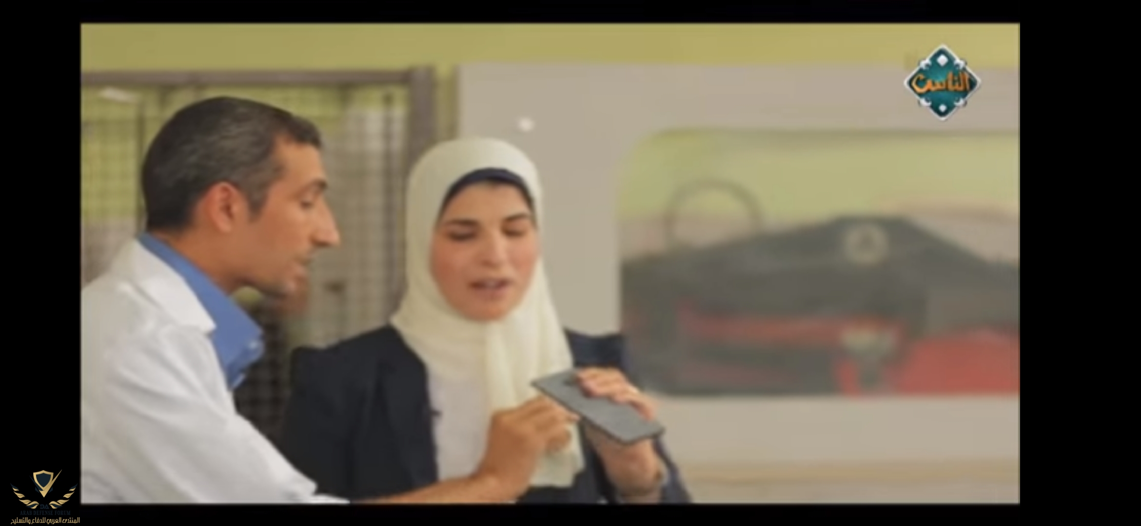

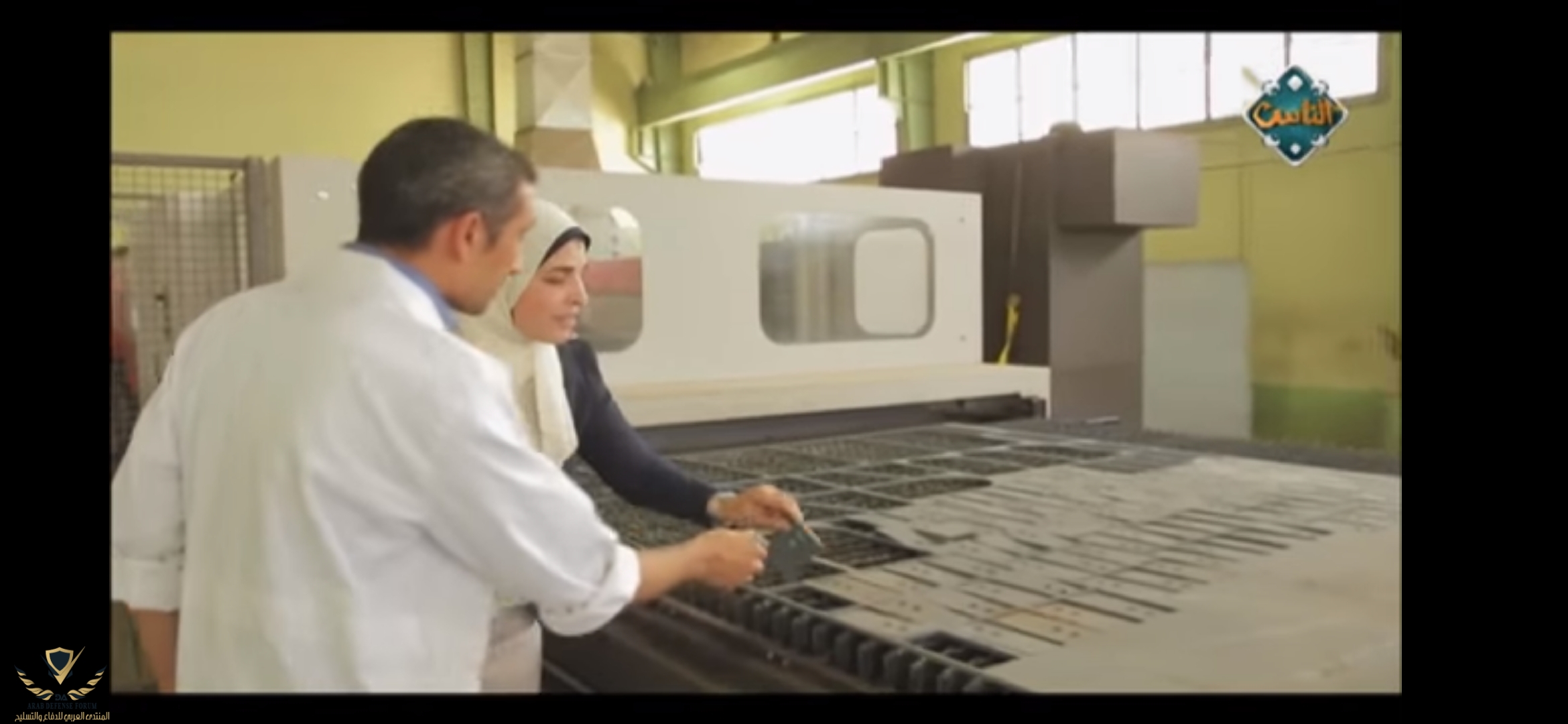

صور لبعض الخامات الى ظهرت فى الفديو السابق من خمس سنوات مع العلم اننا لسه معرفناش الصلب ده هيستخدم فى انهى موديل واصداى من الفهدالدروع الشرقيه تحتوي على طبقات من الصلب أو الألومنيوم، فالكفاءة الكتلية للدروع الصفائحية ليست مرتفعة مثل درع السيراميك الدروع متعدد الطبقات التي تحتوي على طبقات بديلة لدروع معدنية بدروع من المواد غير المعدنية مناسبة. وعلاوة على ذلك، فإن فعالية الدرع متعدد الطبقات يمكن زيادتها بزيادة تباعد الطبقات .
بدأت قدرة السيراميك المدعومة بطبقة من الألومنيوم أو من البلاستيك المقوى لتوفير الحماية رغم ان وزنه أقل بكثير من الدروع الفولاذية المعادلة 2.4.
كما ادمج أكسيد الألومنيوم على شكل كتل سميكة نسبيا في أنظمة الدروع التفاعليه سهله الاختراق لمضادات الدروع Heat
الصور مش واضحه لكن سمك الدرع وكثافته بيتهيألي انو حديد ظهر معالج نسبياصور لبعض الخامات الى ظهرت فى الفديو السابق من خمس سنوات مع العلم اننا لسه معرفناش الصلب ده هيستخدم فى انهى موديل واصداى من الفهد

فى فيديو فوق الصور انا واخدهم منه صلب مدرع السمك 8مل انت مبتراجعش المواد الى بتتحط فى الموضوع ليه يابيه قبل ماترد لو تعبت ارتاح شوية احنا هنا بنتكلم فى مستقبل الولادالصور مش واضحه لكن سمك الدرع وكثافته بيتهيألي انو حديد ظهر معالج نسبيا
