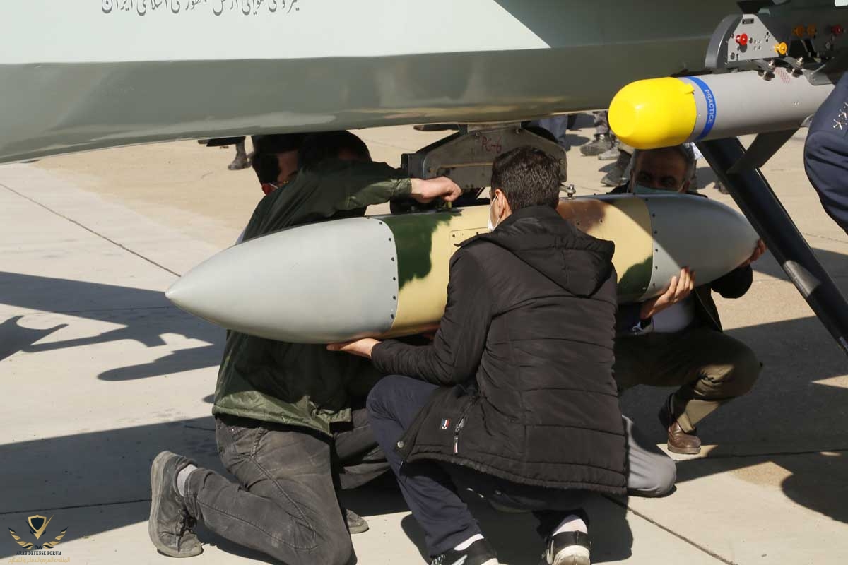

لا تحملهن في نفس الوقتكيف الحمولة 300 kg فقط و تقدر تحمل قنبلة قاصد + قنابل موجهة؟
L @larbi

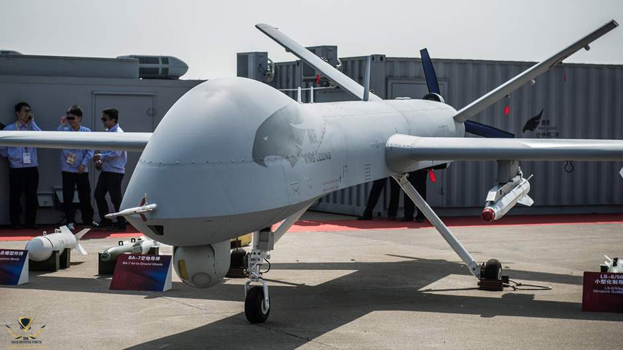

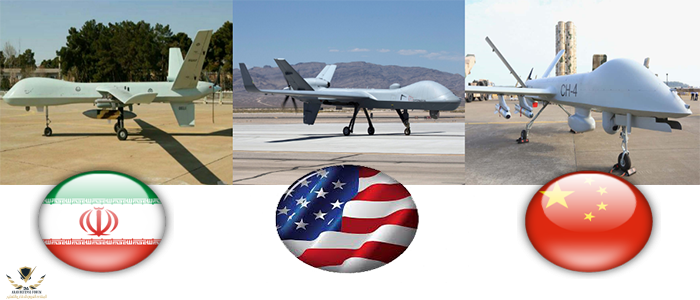

هم يصنعونها ادخل على هذا الموضوعالمسيرة تشبه الى حد كبير الامريكية الرايبر MQ-9 Reaper و الصينية CH4 Wing Loong
مشاهدة المرفق 357656

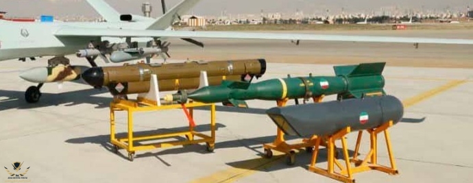

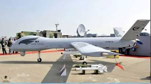

بس كيف استطاع الايرانيون تطوير منظومتها التهديفية CATS
مشاهدة المرفق 357658

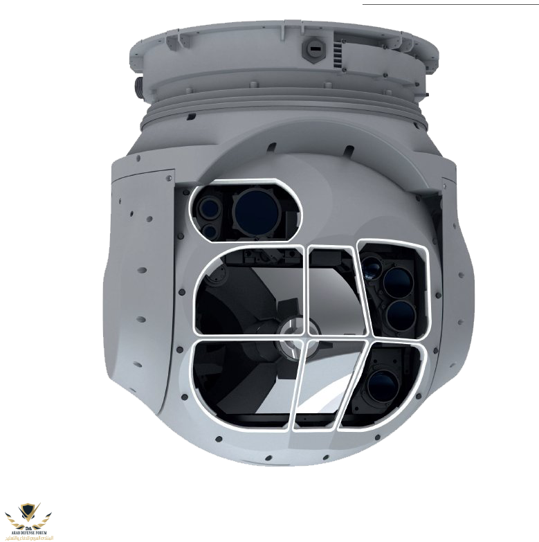

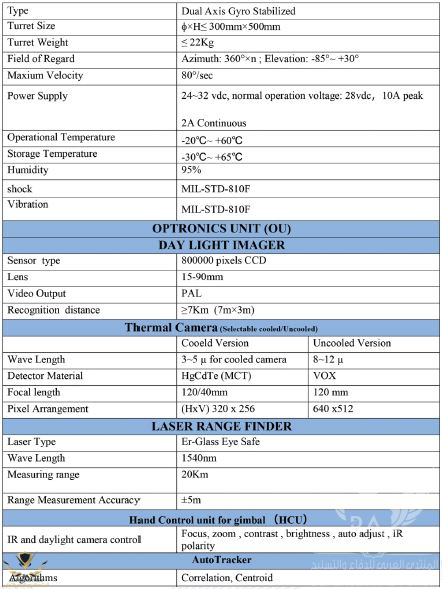

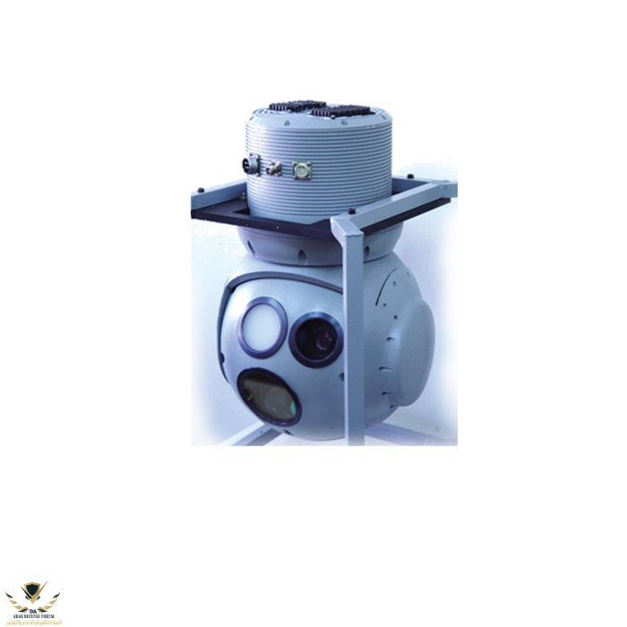

EOG 3000-C
مشاهدة المرفق 224924
“ EOG 3000-C ”
Electro optical gyro-stabilized system
EOG 3000-C with gimbal diameter of 30cm and weight of less than 22kg and having cooled thermal camera with high resolution (320×256MCT) and 120mm of focal length, 20km eye safe laser range finder and 36X vision camera, is an export product that has been exported in a large quantity. It is capable of accurate positioning and automatic video track. It can be installed on UAVs and different helicopters.
Features
ں It is possible to have any desired sensor arrangement or to change the sensors in the product
ں Having high gyroscopic stabilization accuracy (200μrad)
ں Capable of communicating with radars, linking with weapon and capable of receiving the coordinates of desired target and positioning the system towards the target
ں It is possible to install eye safe laser range finder and vision and thermal camera and so positioning target coordinates accurately
ں Utilizing high resolution cooled thermal cameras with focal length of at least 120mm
ں Using mechanisms of advanced vibration isolation in a way that it is possible to make use of complete capabilities of the cameras (the end of camera zoom)
ں Utilizing advanced video tracker based on DSP-FPGA capable of predicting target position if there is an obstacle in camera field of sight
ں Considerable export quality
مشاهدة المرفق 224925
