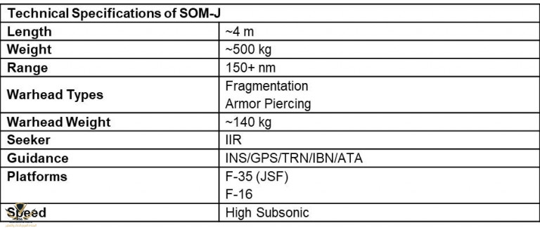

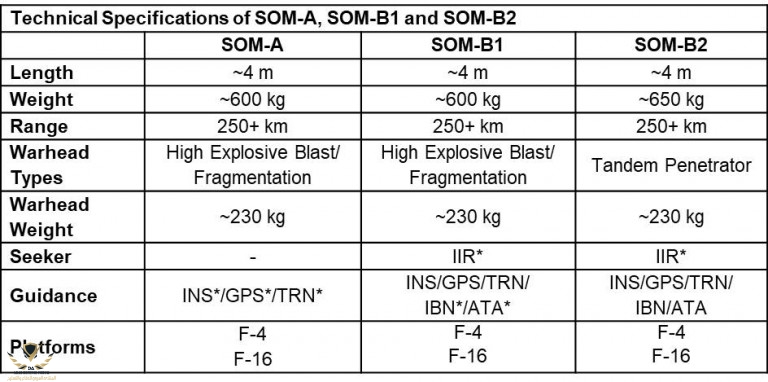

Work on the serial production and development of different versions of the Stand-Off Missile (SOM), which has been developed as an air-to-ground/surface cruise missile to meet the requirements of the Turkish Armed Forces and those of friendly and allied nations, continues at full speed. The current members of the SOM product family are the SOM-A, SOM-B1 and SOM-B2 versions for use against ground targets, and the SOM-J version for use against naval targets. SOM-A and SOM-B1 feature a high explosive blast fragmentation warhead; SOM-B2 has a tandem penetrator warhead; and SOM-J has a semi-armor piercing warhead. The missile can select between missions based on pre-flight programming and it is possible to select the parameters used to hit the target.

SOM-A: Basic SOM; with HE Warhead INS/GPS guidance with TERCOM
SOM-B1: SOM Missile with HE Warhead; INS/GPS Seeker, TERCOM and IR based Navigation with ATA capabilty
SOM-B2: Similar to SOM-B1 with penetrator warhead

SOM-J: Antiship variant specially developed for F-35s with Block4 Software. Developed by ROKETSAN and SAGE. It is main competetor against Kongsberg JSM Missiles.
