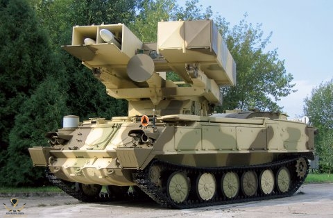

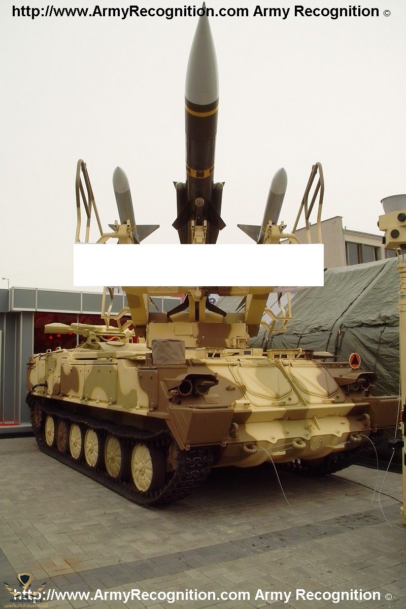

ما رأيكم بهذه الصورة إخواني
سام 6 متحرك؟ و من الأصغر؟

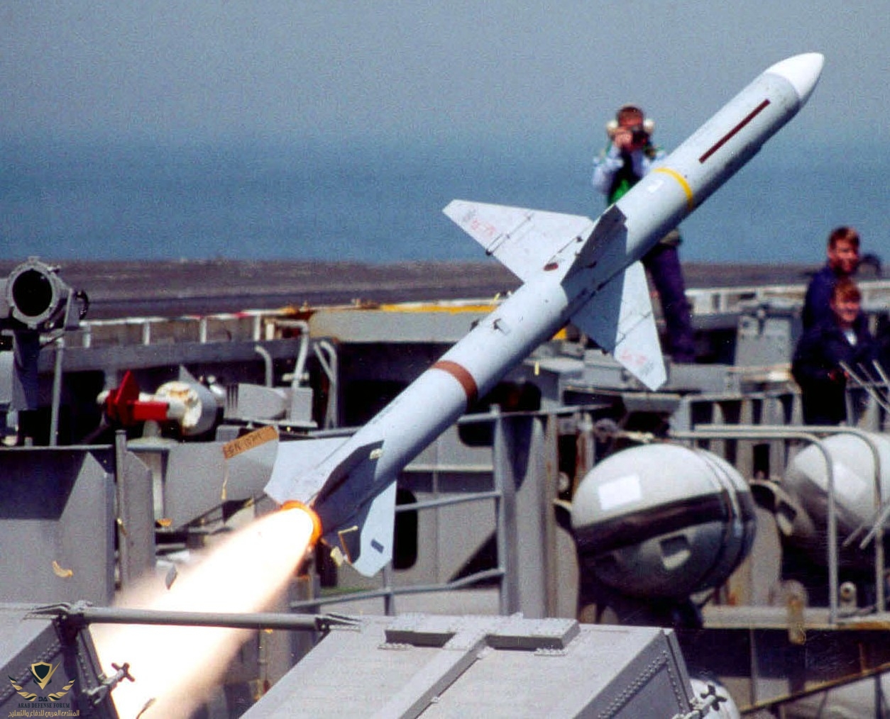

عربة سام ٦ مع صاروخين غربيين و واحد شرقي
ما قصت هذه العربة و هل الرادار واحد و يوجه النوعين
ربما نسخ للعرض فقط
الصور الاولى اعتقد تمتلك رادار (دائري)

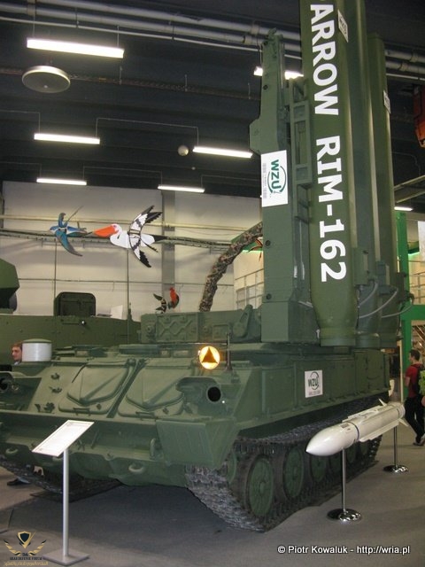

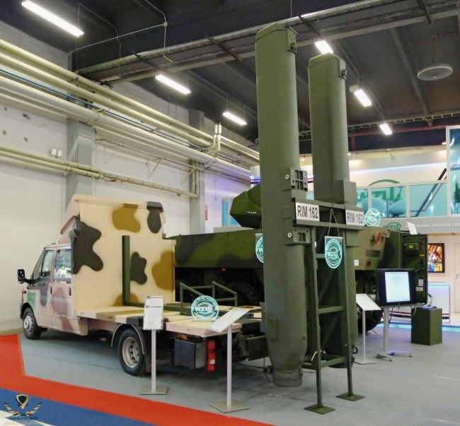

حسنا ماقصتها
Abstract
Wojskowe Zaklady Usbrojenia Nr 2 (WZU-2) in Grudziadz has announced a scheme to upgrade the Russian 2K12 Kub (SA-6 'Gainful') tracked surface-to-air missile system by adding Raytheon RIM-7 Sea Sparrow missiles. The RIM-7 missile is cheaper than AMRAAM and more available for international customers. The RIM-7P, a surface launched derivative of the AIM-7 Sparrow air-to-air missile, has been out of production for some time but is due to be supported by Raytheon until at least 2025. WZU-2 hopes to make the first live firing of a RIM-7P from the 2P25M2-P1 launcher in mid-2008, if all necessary permissions can be obtained from the US government. The WZU-2 has also developed the successful 1S91M2-P1 SURN upgrade package used by the operational units of Poland and Hungary and by training and simulation commands of German
