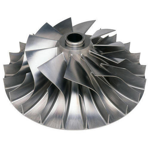

The U.S. Marine Corps has plans to use 3D-printed impellers on M1A1 Abrams main battle tanks, according to a statement.

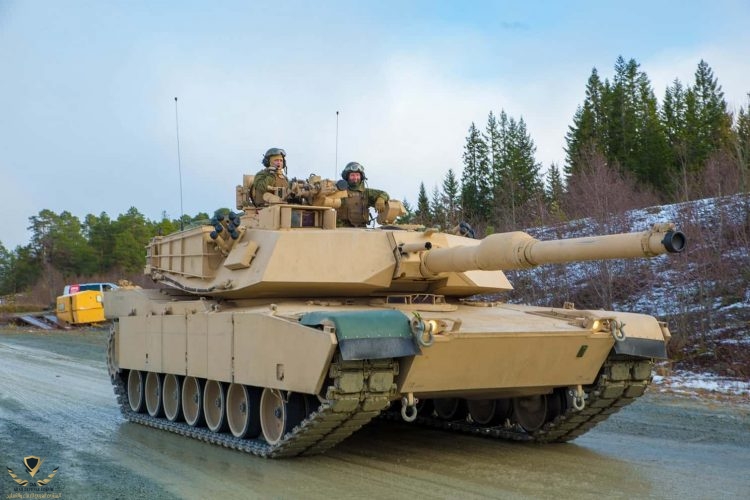

Marine Corps Systems Command recently collaborated with fleet Marines and other organizations to review the successful performance of several 3D-printed impellers used on M1A1 Abrams tanks at Twentynine Palms, California.
The Corps plans to use 3D-printed impellers when the original part wears or becomes inoperable and a new part cannot be received in a timely fashion.
“Call it a spare tire or a stop-gap solution,” said Joseph Burns, technical lead for MCSC’s Advanced Manufacturing Operations Cell. “This can get you through a mission, through your training exercise or whatever may be critical at the time.”
An impeller expels dust from the tank engine to keep the filters clean. When an impeller experiences wear and tear, the part may not pull enough air to function properly, which could degrade mission effectiveness.

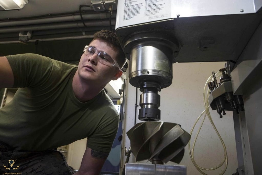

“Around that time, the Marine Corps had been provided with 3D printing additive manufacturing tools,” said Burns. “And Marines were being encouraged to be innovative and develop prototype solutions to real-world problems. A young Marine identified the impeller and began exploring ways to 3D print this part.”
