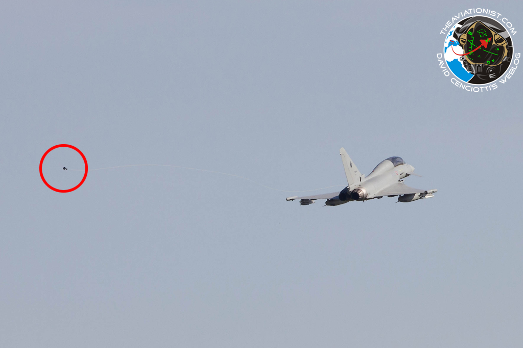

According to the information released by Eurofighter, the TRD is attached to the pod using a Fibre Optic link used to send commands to the decoy radio frequency emitter to produce jamming signals required to lure the missile away from the “parent aircraft”.
Even if the Eurofighter website contains several diagrams showing the Typhoon’s towed decoy, no image can be found of the decoy being towed by a plane, except the following ones taken by Gian Luca Onnis (during an unclassified test – image released).
